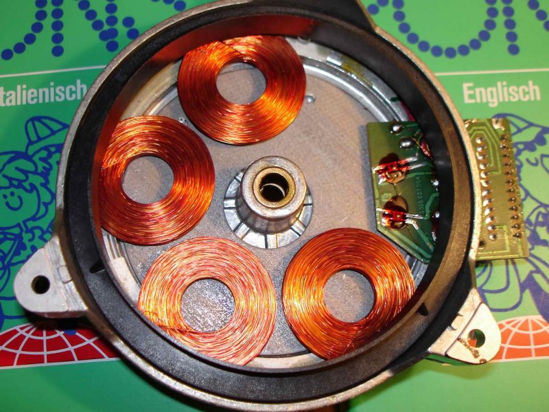

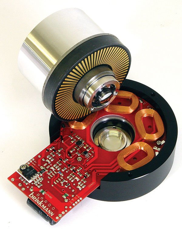

Exsample brinkmann bardo motor is a modern version from dual eds 920/930. Of course good enough for high class diy turnable.
the eds 1000 should be even smoother but needs a more complex controller

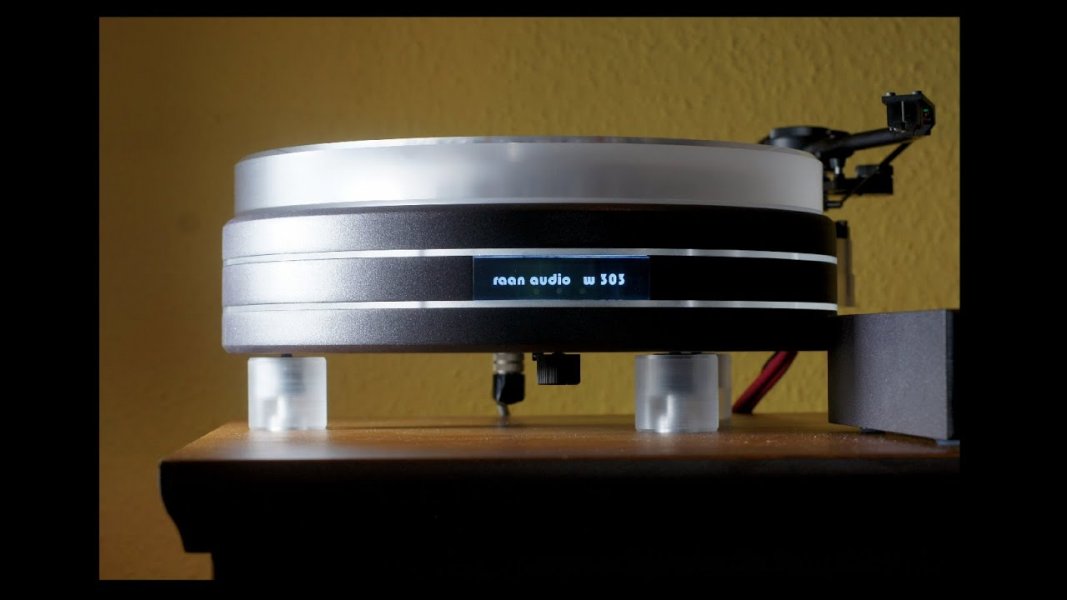

Here a modern project with eds 1000, the raan audio w303. From AAA forum germany maxresdefault.jpg raan 148-001.jpg

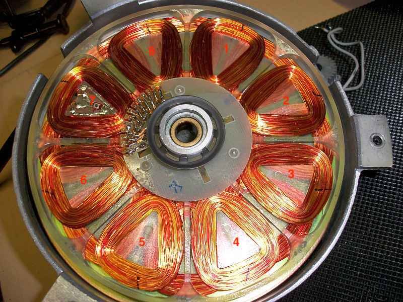

Eds 1000/2 motor is the powerfuller motor from a dual 721.
If the power supply had been outsourced and a better plinth had been given, it would have been the high-end machine of the 70s.

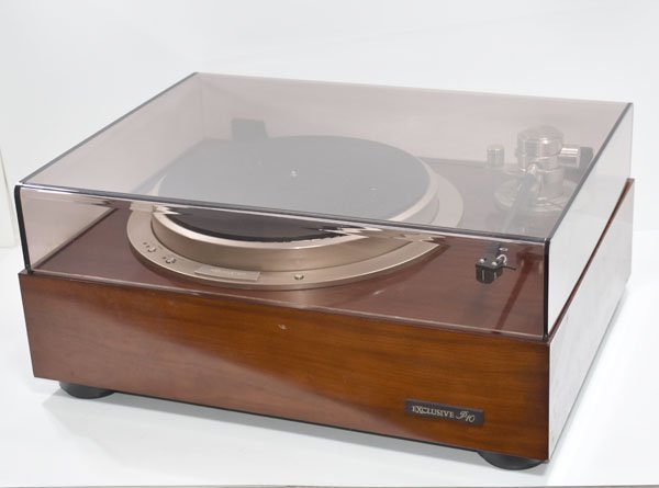

does anybody of you may have a service manual for the Pioneer Exclusive P-10 in english language?
theophile
Hi folks,
Japanese domestic market product only.
