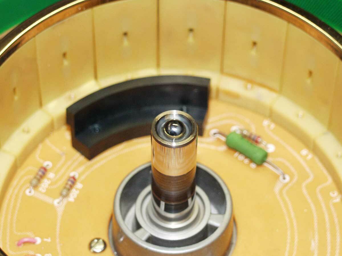

Close up of the P3 motor (couldn't find another one). As you can see, it looks VERY similar and designwise is the same. I think that Pioneer moved the controls onto the motor itself (the controls of P3 are in the plinth) that allows it to be standalone. The P3 has a heavier plinth and probably a better arm but the motor itself looks nearly identical. Maybe the control circuitry for the P3 is more advanced but I somehow doubt this.

Interestingly, the P3 and P10s motors do not look like any other coreless/slotless designs, which usually have coils of wire in oval like shapes evenly spaced or a staggered star patterns. The P3/P10 motor has the magnets oriented vertically rather than horizontially and the wires I guess run through these yellowish spacers making the ring where magnets are on either side.
They were different. in may respects the closest is the Onkyo PX100M, though that has no magnets. Similar insofar as the rotor passes through the coils on either side. Only the copper platter is the rotor.
