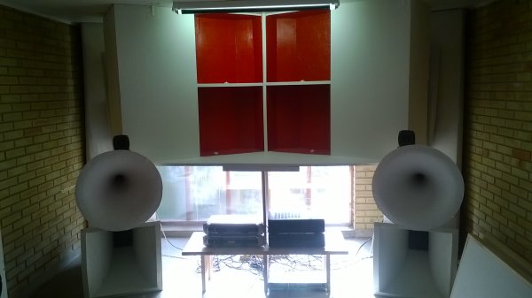

This is my DIY 4 way active horn setup. It cost me about 2500 $ to make, about 1/100 of the topics max price and that is including amps and x-over and the lot :) All is time aligned and I use EQ to tame the room modes, which I find crucial to get a smooth and engaging sound.
Most of the drivers and amps was bought used. It was build with the Avantgarde Trio Basshorn as inspiration.
People who have heard the Trios, says that the are equal to them in terms of sound quality and I have had more than a dozen of people saying, that it is the best soundsystem they ever heard.
The room is treated with DIY bass traps and absobers on the backwall and 3 big panels (240x60 cm) made of double plasterboards with 5 cm glass wool, hanging over listening position.
Regards Sebastian
Regards Sebastian
Congratulations Sebastion.
I am not surprised by the above statements; especially "I have had more than a dozen of people saying, that it is the best soundsystem they ever heard."
Best to you,
zz.
Regards Sebastian
Sebastian, where are you located?

Hi FrantzM, here are the basic info.
If this is OT please feel free to remove the post.
The system has 6 x 500 liters front loaded basshorns, each with Fane Collusus 15XB. 4 of them are hanging from the ceiling and forming the Great Dannebrog Horn and 2 extra cabs for bass distribution, a la Earl Geddes multi sub princip. I'm still fiddling around with the extra2 subs, trying to integrate them, might need some help down the road from a friend, who has experience with multi subs. They load down to 23 and rolls of at 90 hz. The main sub horn is runned by a Behringer Inuke 6000 DSP, with 2 x 2000 watts into 4 ohm.
From 90-500 hz Electro Voice EVM 15L in a front loaded horn and a Behringer Inuke 1000 DSP powers it.
A paper mache horn loaded with JBL 2445 driver handles the 500-5000 hz, powered by a NAD 7100, which also functions as a pre-amp.
From 5000-20000 hz a Selenium ST200 bullet driver comes in with an Onkyo TX-V940 amp.
2 x Behringer DCX 2496 handles the x-over, time alignment, EQ and gain structure.
All cables are DIY, nothing fancy or any bling bling :rolleyes:
Total system sensitivity is around 110dB/w, so as for amps, I do not believe, nor do I hear, any major differences between topologies as long they are linear, don't clip and don't distort. And in active mode I think, this is even more true.
Regards
