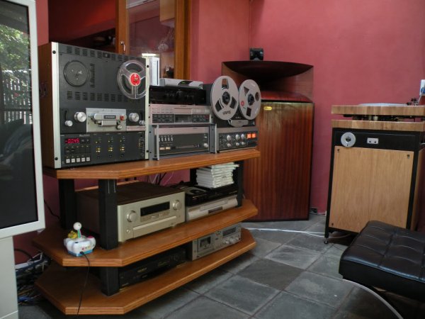

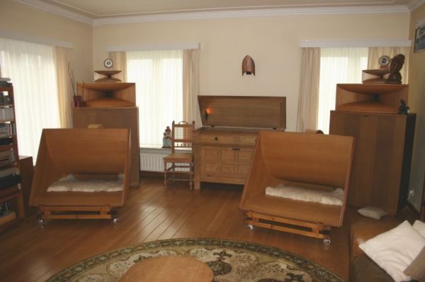

I am no expert but as a fellow Klipschorn owner I can say the following:
1. I do not think anybody really knows the effect of room treatments on the bass response of a corner horn. Any treatments in the immediate vicinity will be in the "extended horn" formed by the room boundaries and vital to the proper functioning of the horn.That infamous upper bass dip may well become a canyon.
2. Ensure that the backboard of the speaker is tightly sealed into the corner.
3. Finally and IMO where your problem lays: The K horn is a hugely efficient speaker that detests the low power single ended amps it is theoretically such a good bedmate for.Nothing wakes a Khorn better than a high powered solid state amp.Klipsch himself used SAE amps despite his often quoted "What the world needs is a good 5 watt amp" statement. My K Horns does much better now in a second system where an old top end Marantz AVR powers it than it ever did with any of my collection of SETS. A brief affair with a big McIntosh SS amp had it sounding better than I ever heard it.
I see that you have changed the "heads" for something better.That is exactely where my problem started. Again only my opinion but I believe Klipsch's real genius was not that he folded a horn but that he knitted a bunch of of imperfect components together to form a hugely satisfying whole. Improve on any of his compromises and the ball of wool unravels disasterously. When I improved the trebles on my K horns the mids was shown to be ragged. When I improved the mids the Khorn's Achilles heel was revealed- that is the basshorn running out of steam before the midhorn can properly take over leading to a sensation of weakness in the bass. That is why Electrovoice in their licensed version of the Klipschorn added a non horn driven fourth driver and one of my horn mentors,Belgian boffin Karel Schees, added a huge WE midbass horn to his.
From Melaudia.net
My K horns in their "graveyard"
