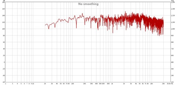

I have done this but still do not know if I have it correct or not??? What about calibrating the soundcard??? I am using a M-Audio Mobile Pre connected to my laptop...
Jayrm;214959]Quick tutorial on REW has been on my TODO list for a while :). The tools is non-intuitive but easy to use if that makes sense. First thing is whether you have a mic. If you do, plug it in and start REW. Then click on the "measure" button on top left. A pop up appears. There are two VU meters. Tap on the mic or otherwise make some noise and make sure it registers on those VU meters (i.e. their levels go up). That takes care of input. You then need to feed the output of your computer to your stereo. A headphone jack to RCA can feed stereo output easily and you can buy the adapter from many places. Once you connect that, press "start measuring." You should hear a frequency sweep from low to high. Get to this point and then I can explain the next chapter :).[/QUOTE]

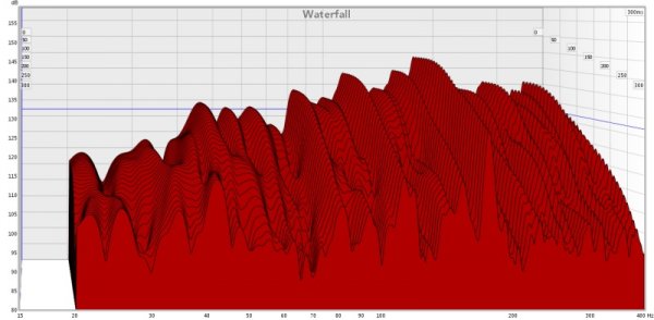

you might need a waterfall plot that shows decay at frequency. tightness and impact are what you are wanting.
and i'm not a guy who can read this stuff. but in my case, my bass was overdamped and the waterfall plot revealed it. establishing solid room boundaries helped it alot.

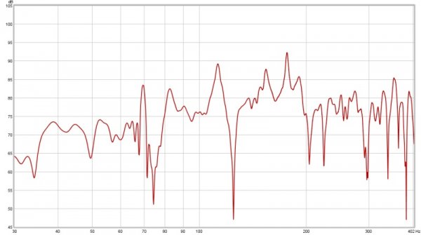

Hi Jcmusic, While we will have to wait for the real experts to chime in here regarding your graphs, I will give you my opinions.
First off I have to ask which interconnects and power cords you are using, cabling has a huge effect on bass speed and power. This is what I would look into.
I would not use any room deadening in your room. I has the effect of killing high freq and imaging, the two big attributes of cornerhorns. Also with these contraptions in the corners you would be fighting the natural workings of your speakers, these speakers were never designed with sound killing absorption in the room.
To keep the purity and essence of you speakers look into better cabling and electronics.
You said "I really only want to tighten up the bass some and I am done, it sounds really good to me now I am just trying to see if it will get better!!!"
Looking at your graphs, which look good to me, with response to 20hz I see no reason to add sound deadening. Though they look like an EKG with a heart attack about to happen!!!

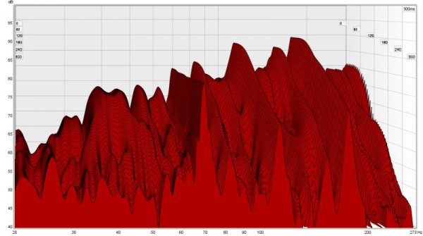

Jcmusic asked, "Are these better? ".
While we are waiting for the real experts again, I will offer my opinion again. The graph still looks like a heart attack about to happen, but my opinion has changed from you just needing better cables to you need an equalizer! I would recommend a Behringer eq. Thats what they use for equalizing home theater audio. Though I don't know how good it will sound on a 2 channel system. But I think that is you only choice.
