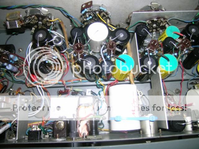

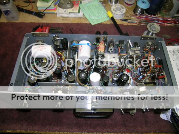

I got a call from my tech that he had finished one of my 350's. Fred Thompson has replaced most of the electrolytics with film caps and also replaced the carbon type resistors with metal film. I wanted to share a picture because I think Fred has done a beautiful job. I can't wait to get the slave and master units back and use them for my tube preamp.
Full size picture at this link,below
http://twitpic.com/47ycag

I got a call from my Tech that he had finished one of my 350's. Fred Thompson has replaced all the electrolytics with film caps and also replaced the carbon type resistors with metal film. I wanted to share a picture because I think Fred has done a beautiful job. I can't wait to get the slave and master units back and use them for my tube preamp.
May I provide some suggestions in your 350's project, change volume control to a step type, change the in put and out put socket to better new one, all wire in sound path change to silver or at least silver cost or better copper wire
cheers
tony again
cheers
tony again
Tony,
Yes that would be good idea. My tech checked and replaced faulty wire with silver, but I'll check to make sure. Thanks

I just noticed looking at the full size picture,that these were made in March 1956. That's pretty cool as these are stereo units.
I dropped by to see Fred(my tech) today to drop off some caps for the slave unit. We started talking about the project and he mentioned the Ampex design in the 350 uses "tree towers" ,that's the connector that the capacitors connect to for each tube circuit. Fred mentioned that it's rare and he has only seen the Ampex with that topology.
Being a Vac owner I happened to visit the VAC website and Kevin has posted a picture of his new flagship amps,the 450's. I noticed the point to point wiring and a smilar design to tree towers. Although not exactly like it given the age of the Ampex and 60+ years later,I thought the basic design was similar. I won't even mention the price point of the Vac's,but knowing Kevin and his cost no object philosphy,they should be stunning. I hope my Ampex preamps sound half as good.
