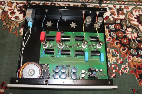

The unit is a Foundation Research V5 from Canada. There are aprox. ten of them built. The company in no longer making anything, but they were more known for their power cords or power filter/conditioners.
Very helpful to have the picture, thanks.
What I'm seeing here is that the designers didn't pay much attention to mains-borne noise. This is obvious to me because top left you see there's an IEC inlet with mains filter incorporated. These are very generic devices not optimized for audio, they include Y capacitors which have the tendency to pollute your earth.
Next in line we have a toroidal transformer - great for low radiated magnetic flux but the poorest choice for rejection of mains-borne noise. If you're serious about modding these two items (filter and transformer) would be very high on my list to be replaced. If you were to replace just one, change the filter to a custom arrangement designed to give much better rejection of common-mode noise, and one without Y capacitors.
This is just the start, I see YashN has further suggestions - definitely the diodes and caps in the main PSU would be next.

Certainly agree with opus112 here on the inlet filter and cap, because of Leakage Currents caused by these, but not sure you can do much except perhaps add yet another AC Filter/Conditioner to deal with additional noise injected into the mains. However, you can still have additional interaction between these caps and other parasitic characteristics. YYMV here as there's also a lesser form of Leakage Current which occurs because on interaction with other supplies and permitted because of interconnects as well.
A couple of more things I will add since there is a Toroid:
- Try to physically locate the Toroid further from the electronics if possible
- Try a DC Blocker prior to the Toroid (it could be placed before the gear's AC inlet)
And a further thought: if you could examine the Layout and especially how the Ground(s) are made, there could be opportunities to optimise further there as well.

Actually the biggest problem with those little crappy boxes for IEC's is that they micro-saturate a lot, but the Y caps are bad too.

I was told the silver box at the IEC is a LC1 power filter from the same company. I don't know if it is something off the shelf or something he made and wrapped it in a box that looks generic.
