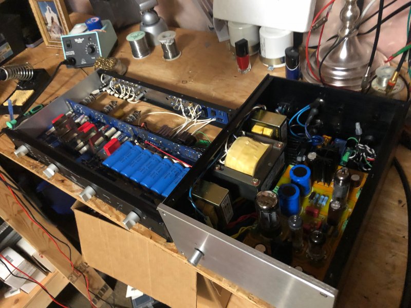

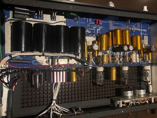

This is an old thread- I used to have Counterpoint products back in the early 80's. For a lark I took a 3.1 a year or two ago and totally upgraded it by constructing a regulated tube power supply with 5AR4 rectifier and el84 pass tube. The old power supply was disconnected in the unit and I added an umbilical cord. The usual cap upgrades and no electrolytics for decoupling all film. I eventually added built in Sowter SUTs as well .Sounds awesome.

I reconnected with a friend just a few weeks ago after 25 years- and he still has his SA5.1 in pristine condition in his secondary system. As you know, these would cook ,bake and fry because of some of the design choices made- but they sounded good.
The real only difference with the SA3.1 is no cathode follower and SS B+ . The gain and RIAA is pretty much identical to the SA 5.1

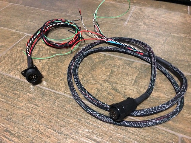

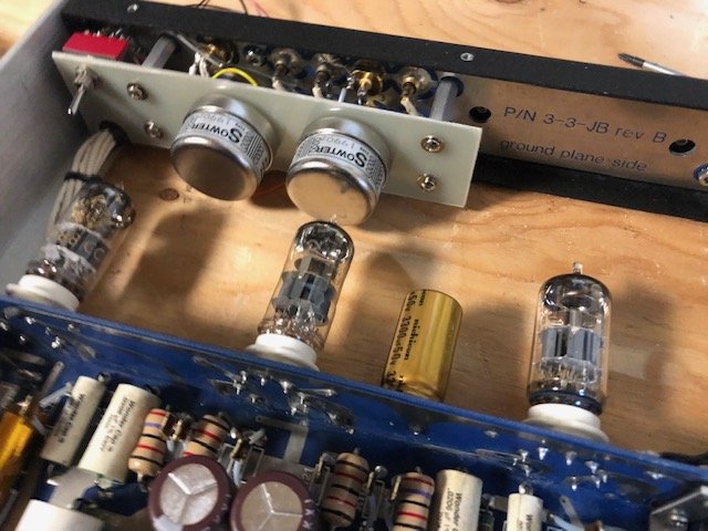

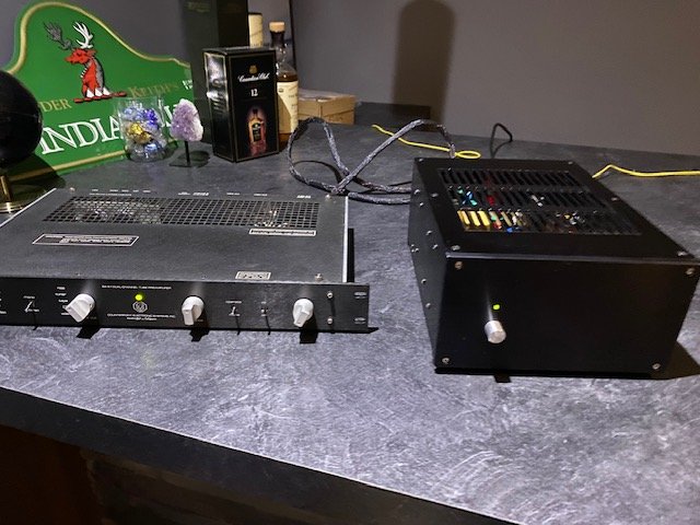

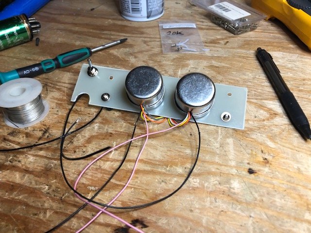

More detail on what I did to mine pictured -no one really wants to attempt something like this because it is far too much work. However, it kept me busy in my basement for a couple of months during the cold winter. I ended up anodizing the front PS panel in lot for another project after realizing the ventilation for the PS I had was inadequate and the case needed more machining. I just throw it in the system once in awhile to show myself that I have probably spent way too much money on my daily driver lol.

Hello Kcin
If you read my previous post I did something similar... well, a technician did the psu for me.
do you think the cathode follower in the 5.1 really ads something? My impression is that the SS B+ makes more difference. What do you think about it?
From your pics I saw you installed Sowter SUT as done by Michael Elliot. Michael used to install the Sowter 8055 now discontinued and replaced with the 1480. However, I contacted Brian Sowter who suggested to use the 9570 as more general purpose SUT. If I read well on the pics you installed the 1990. What's your experience? Have you tried also other SUT?
Hi Pico,
I have not tried other built in type SUTs- the 1990 is configurable 1:10 and 1:20 with a flip of the switch - so more universal for my purposes.
I agree that the tube PS is a greater influencer. As long as your cables are under 2M and you have a sufficiently high input impedance on your amp- one could argue that the 3.1 might be superior from this perspective.
This was just a fun project for me to re-kindle some memories.
