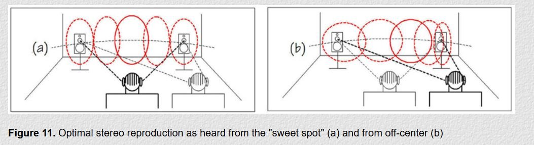

The characteristics of sweet spot in stereo have always been a controversial subject in the high-end. Perfect stereo assumes symmetry and central position, but using methods and tricks based in psycho-acoustics audio designers created solutions having a wide sweet spot, preferred by some audiophiles.

directivity control, dispersion pattern evenness (control, narrowing, widening), speaker pair matching, in room bass management to get as smooth of a low-end presentation without nulls are all factors that give a sense of locked in centre image. Also, on axis and toe out angles too.
Reason why competently designed coaxial, horn and baffle speakers that are matched well and in a room that is acoustically not overly compromised always sound locked in with a superb phantom centre. And experiencing that in a studio space is what led me to overhaul my space and be more serious about checking the CEA dataset of my speakers
Interesting topic. Speaker design definitely contributes. Must say it always amazes me how well you can get imaging dialed in between placement and toe-in. Then you have the room acoustics which also are a big factor which can help or hinder.
It is also surprising how differing speaker types sound in the same room and getting them dialed in can be quite the challenge.
