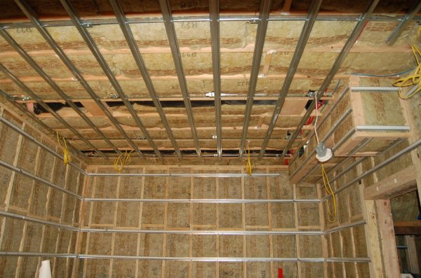

1. Inside walls are up and insulated with Roxul. Also damped-resilient channel by ASC was used throughout.
2. Attention to detail behind the walls! You can see the yellow Romex hanging from the ceiling. This is for the lighting and will be strictly on the house current and not on a separate power supply from the studio.

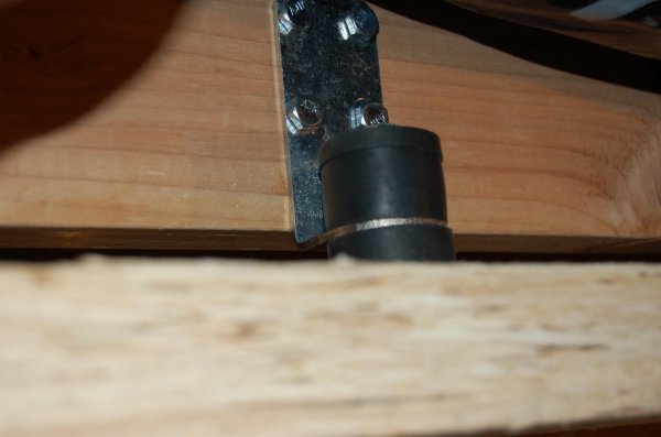

1. Pre-hung ceiling springs by Kinetics Noise Control. As you can see, no seams left out from acoustical caulking!!
2. Hat channel for ceiling
3. First layer of drywall on ceiling.
