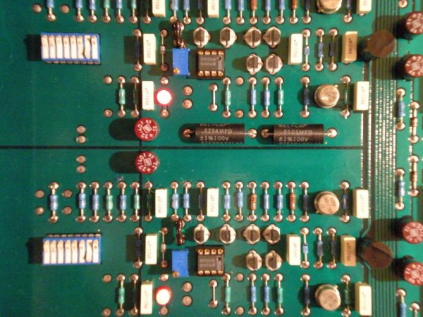

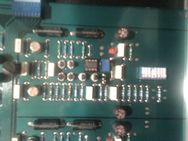

Thanks a lot Demian! Now I'll try it for sure. I also have a question on behalf of an Inet friend of mine about the DMC-5. He needs to know just how to set the rocker switches, and gain for phono cartridges. Here is a blurry picture that he sent me, to refresh your memory. I will also send him a link to this forum and thread.
I REALLY appreciate your answers on these two threads regarding Spectral. They are so hard to get a hold of or find info on.
That's beyond my memory and the picture is a little too blurry for me. You might be able to tell by looking at the resistors next to the switch. My guess is that the switch closest to the left in the picture will change the phono gain from 32 db to 40 dB. it will sound better in the high gain position. The rest correspond to the adjcent resistors with all off equal to 47.5K Ohms (My personal recommendation for everything. . .). If i could see it better I might be able to offer more insight.
Hi, I am the guy looking for info and It's a true pleasure to get in touch with you personally. I apoogize for the blurry picture and i give a try with a new one here below. Meanwhile the seller have been able to get in touch with Spectral (easier for him as I live in Italy) and there informed him switch from 1 to 7 are related to load being 7 the 47K value (now in on position in the picture to mate with high output MC), while selector 8 is the gain. Does this makes sense to you as well? I currently use volume at aroun 11am-12am position. So extra gain would not be needed as the cart gives 2,5mV. Based on your post, should I anyway go to high gain and consequently reduce the volume control? Thanx so much and cheers from Italy Daniele
