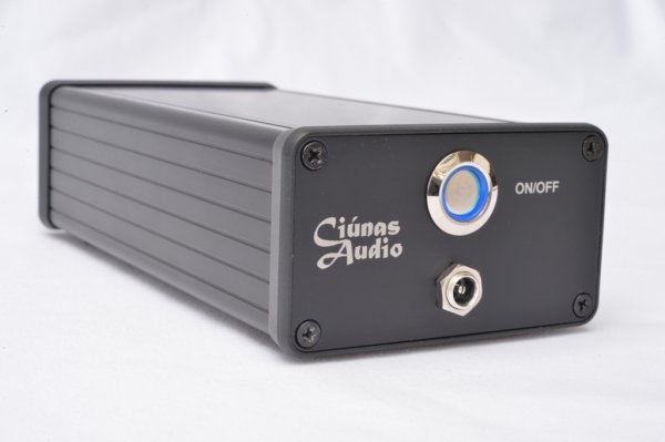

A picture of the device might aid understanding
