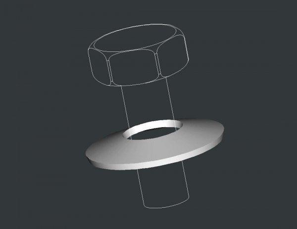

Has anyone tried a Belleville washer? They are made of spring steel and you can precisely torque them down.
http://www.mcmaster.com/#93501a003/=xr84j3
As they absorb vibration, you can be quite precise about the torque and you don't have to over-tighten (which is what scars the headshell).

if these type washers apply ...
have used 'em in many applications, but never with a cart. They do come in very small sizes required tho, and they might work in regard to the OP problem.
