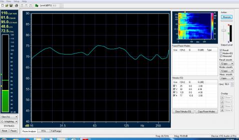

It's nice to have subs with alot of controls. I made a couple of adjustments and here's my new corrected bass response:

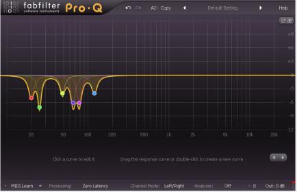

also, here's a screenshot of fabfilter EQ settings:
Just my personal opinion, but I would never use additive EQ and only subtractive EQ at <3dB.
Graphs look great though.
Bruce, I found this thing called a volume knob on my plate amps. I re-ran my measurements with said volume turned up slightly. You are correct. It is better to give than receive. :) Here's the new measurement:
and my new EQ settings; no need to add any gain into EQ now:
