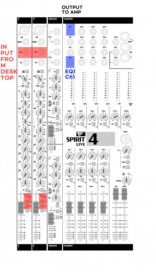

Hello.
I'm trying to connect the mixer and equalizer with an insert cable, and I'm using the equipment below.
Mixer: Springs live 4
EQ: Dod SR231Q 31band 2ch
Cable : TRS - 2 TS cable.
I made a cable for testing, connected the mixer and equalizer, and checked the signal coming in.
But if I adjust any frequency on the equalizer even a little bit, I get a loud beeping sound.
I tried making a new cable, but that didn't solve the problem.
I'd like to get some advice on which parts I should check.
Attached below is a screenshot of the mixer I connected.
Thank you.
