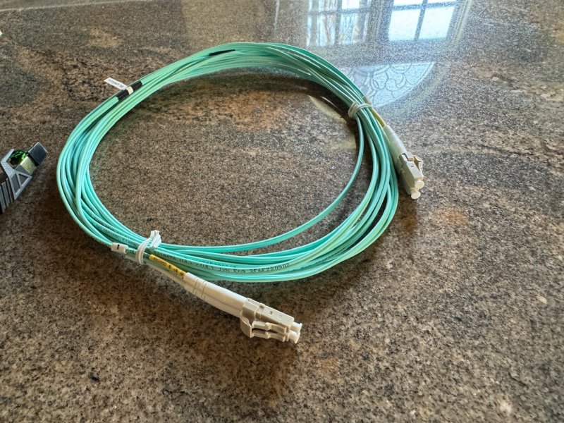

Thanks TCR80. Great feedback and much appreciated. I got the OFNP plenum multmode duplex fiber optic cabling today along with Finisar FTLF1318P3BTL transceivers. Plugged everything in. Thought it was going to be plug 'n play but i was mistaken. Running ethernet from router to Teradak TS212, then fiber to the SFP port on 2960G, which then distributes ethernet to the streamer etc. No dice I'm afraid. I deleted then reinstalled the control app on my iphone and ipad, went through setup again, which uses a QR code on the streamer screen that the iphone scans to complete pairing. Kept getting a message that the control device (iphone with app) has to be on the same LAN to complete setup, so for some weird reason it sees the connection that has gone through the converter as a different LAN or IP address? Very frustrating. I did check an ethernet cable running directly from the router, and the from the 2960 fed by ethernet (not teradak fiber) and it works fine? Frustrating.. Any ideas?

Your new optic appears to be single mode (1310nm) but you say you’re using multi mode cable?
If your optic has a blue handle you should be using a yellow cable.

I believe its multimode. That is what the item on Amazon described

will multimode not work? Fair enough. I will get the single mode cable ordered today too. I will still get the additional converter just in case. Thanks!
You may have other issues but at least start with the right cable.
