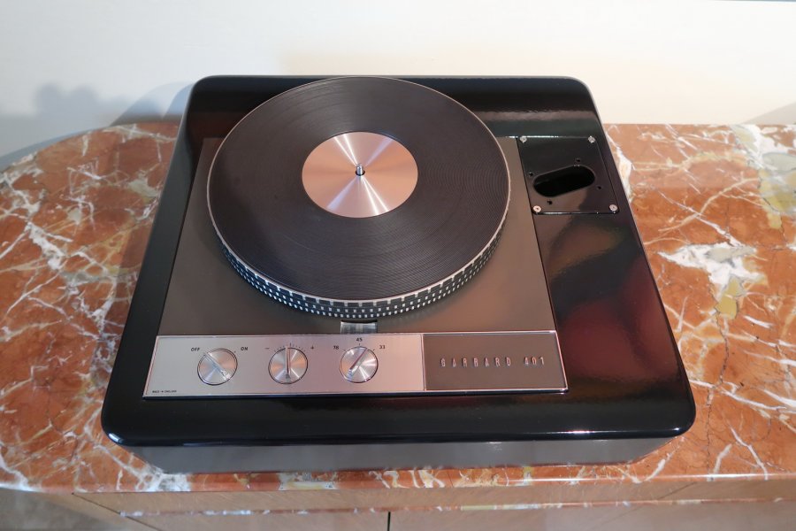

My 401 just rebuilt by Ray Clark, the Classic Turntable Company
My 401 was shipped yesterday morning and arrived today via DHL, it came straight to Miami. My SME came via Fedex and went to Memphis first. It seems to me that DHL uses its own planes.
I would like to thank David who kindly offered to help me out if there’s a problem.
Cheers,
Horacio

At this point of the game the outlook is not promising. Repainting the chassis added an extra layer of lacquer, the plinth needs to be enlarged a few millimeters and repainted again.
