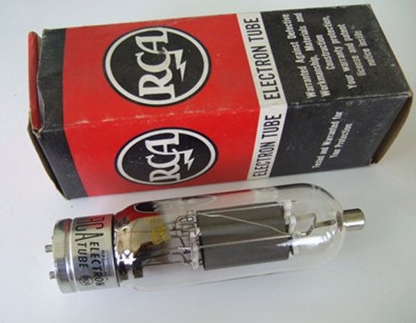

Got a pair of NOS RCA Electron 805 tubes but they aren't matched. Didn't find a matched pair anywhere. Will there be a sound degradation using an unmatched pair?

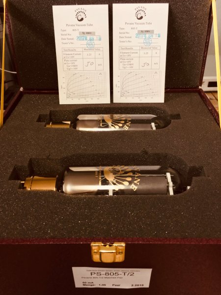

Thanks for trying to help but isn't all this work pointless? I mean I'm not going to use the tubes anyway if you say the difference is audible in unmatched pairs. Also got a new factory matched pair of 805-T/2 Psvane's, wouldn't it be better to use those instead and sell the RCA's?

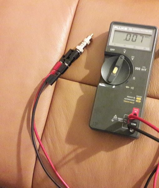

A Fluke 113 is on it's audiophile way! :cool: Will be delivered tomorrow.
Great - but now in order to use your 113 to calibrate your system you should add a few inexpensive accessories :
https://www.amazon.de/BestPlug-Verb...1537485141&sr=8-15&keywords=cinch+adapter+bnc
https://www.amazon.de/SIENOC-BNC-St...F8&qid=1537485184&sr=1-6&keywords=adapter+bnc
https://www.amazon.de/MagiDeal-Mult...77&sr=1-2-fkmr2&keywords=Magideal++cable+4+mm
One black and one red cable, preferably!
Using these parts you will easily measure the output voltage of cinch outputs and will be able to calibrate your system. After you got them I promise I will start a thread on it!
