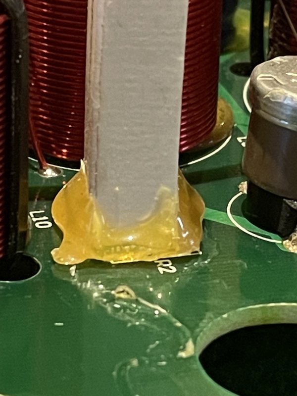

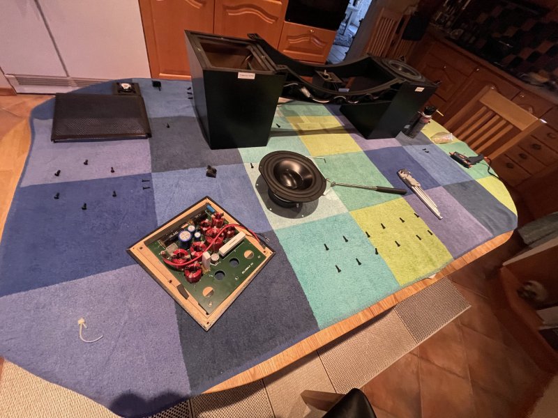

F2C677FD-E8C1-4E4E-9FED-B258D24A2897.jpeg1418AF77-8988-486D-990A-7CB5DDE7EA8A.jpeg5259D522-0712-4018-A3B8-53234721470D.jpeg613A3112-96BB-42D8-A7F3-0936CCE736D5.jpeg
I found actually a lot of cabling sitting quite loose, which I now have tighten, and sprayed all the contacts and joints with highly professional oxidation spray for better connections.
Then I found a big standing component on the crossover board were the glue in the bottom had come loose, and it just stod there swaying freely…. Well not anymore.. I glued that sucker firm to the board?;)!
