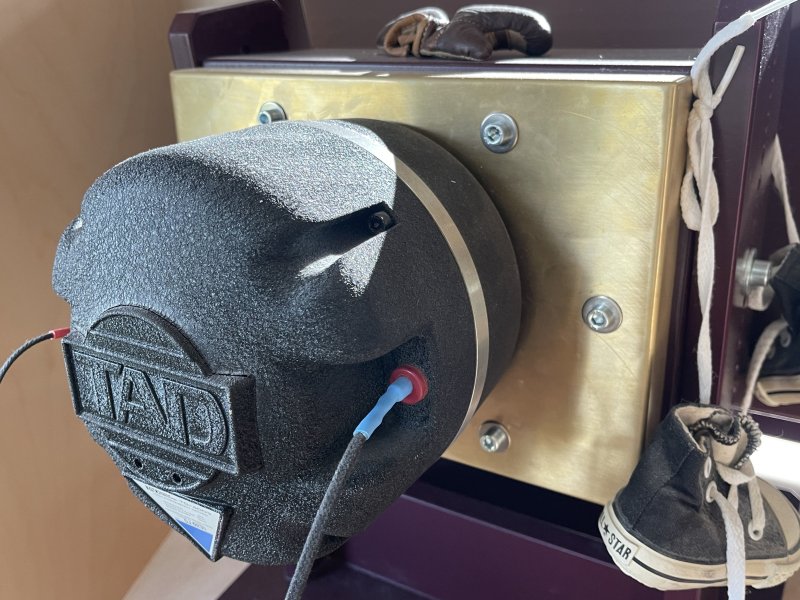

DIY CD horns for TAD TD-4003 incl custom cnc´d bronze adapters 600-20K driven by all out Borderpatrol DIY 300B dual chassis monoblocks.....all signal iron is nanocrystalline cores from Tommy Hørning in Denmark

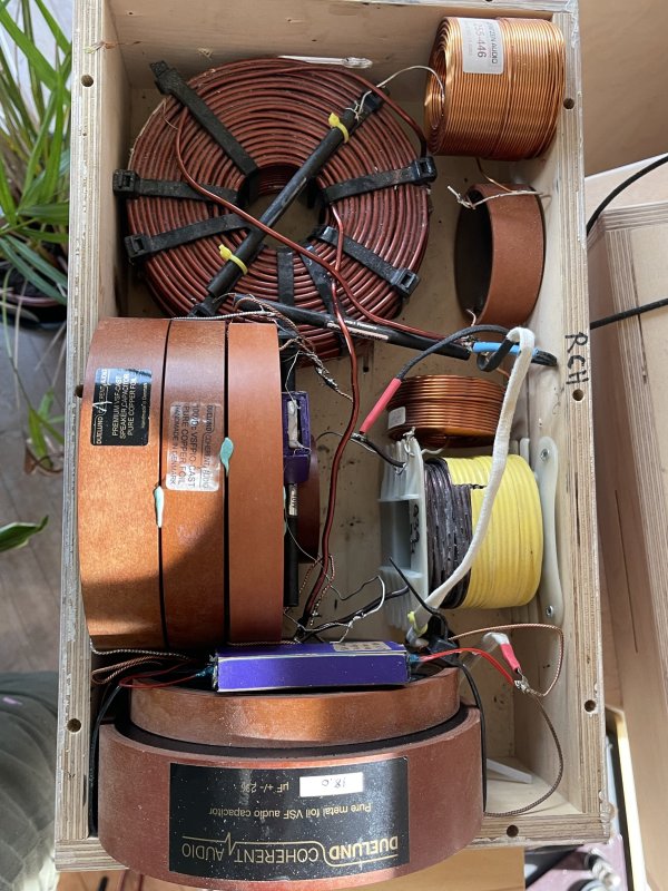

4003 hipassed with Duelund cast cu passive filter...includes some esoteric platinum resistors and capacitors, Northcreek and Intertechnik inductors and Duelund CAST resistors

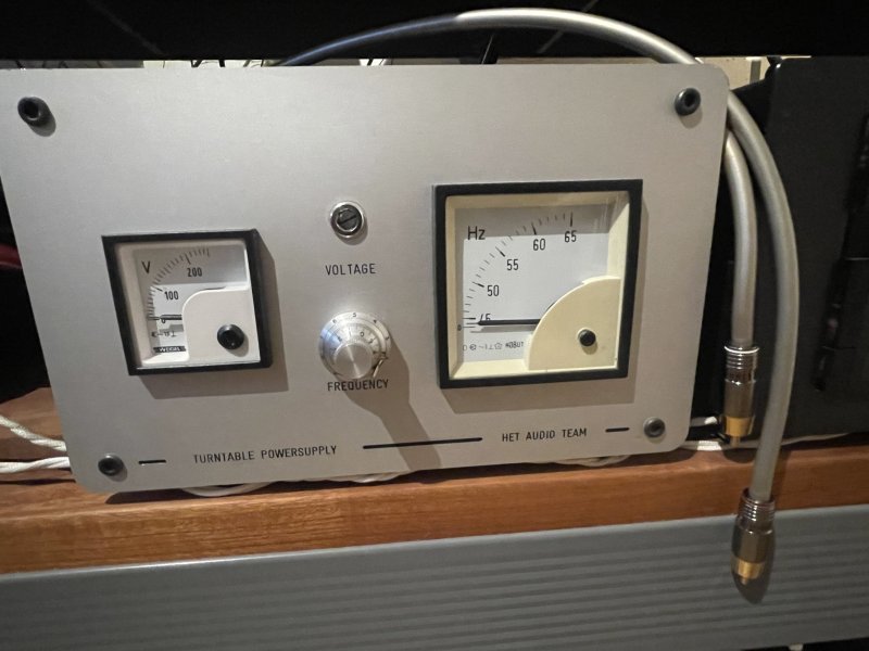

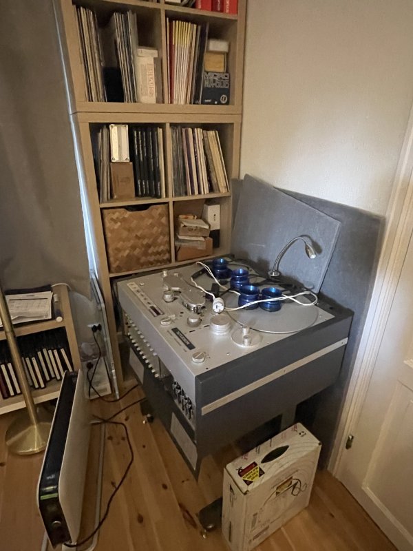

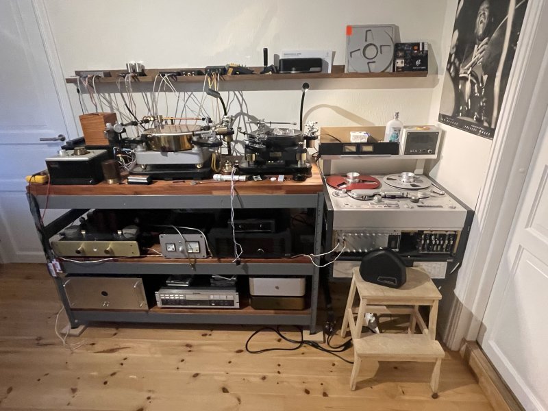

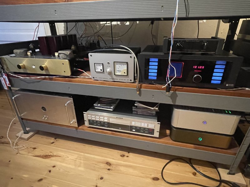

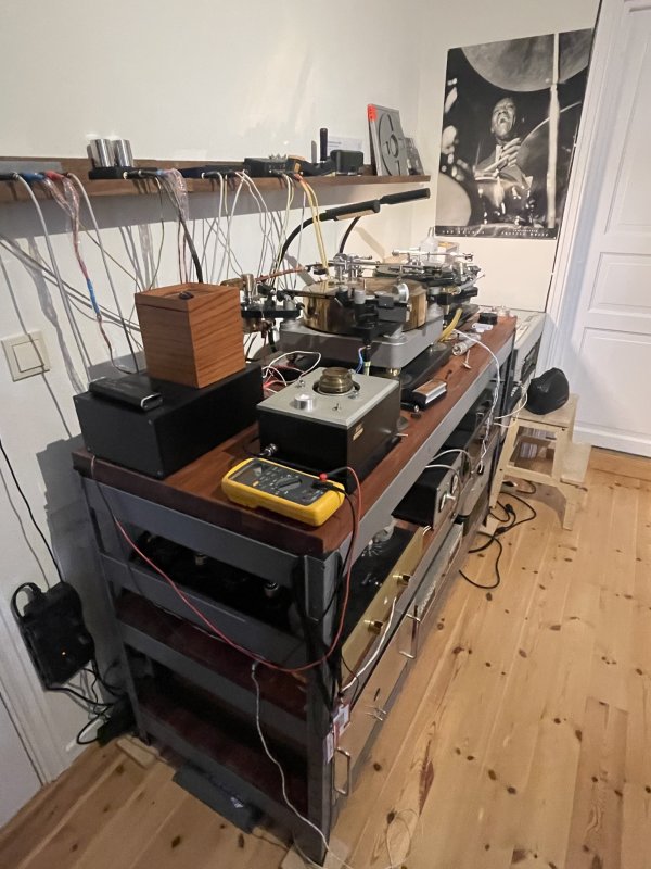

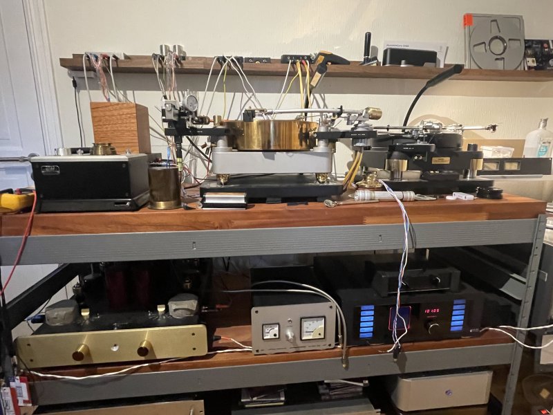

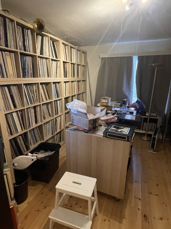

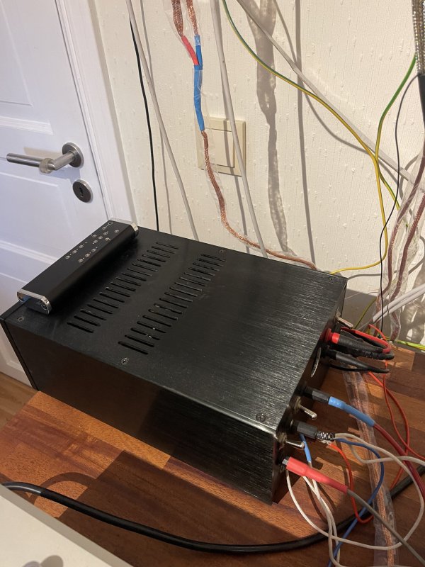

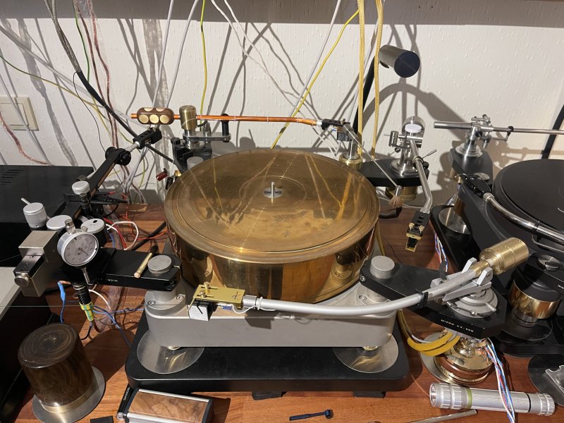

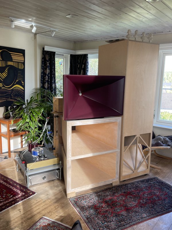

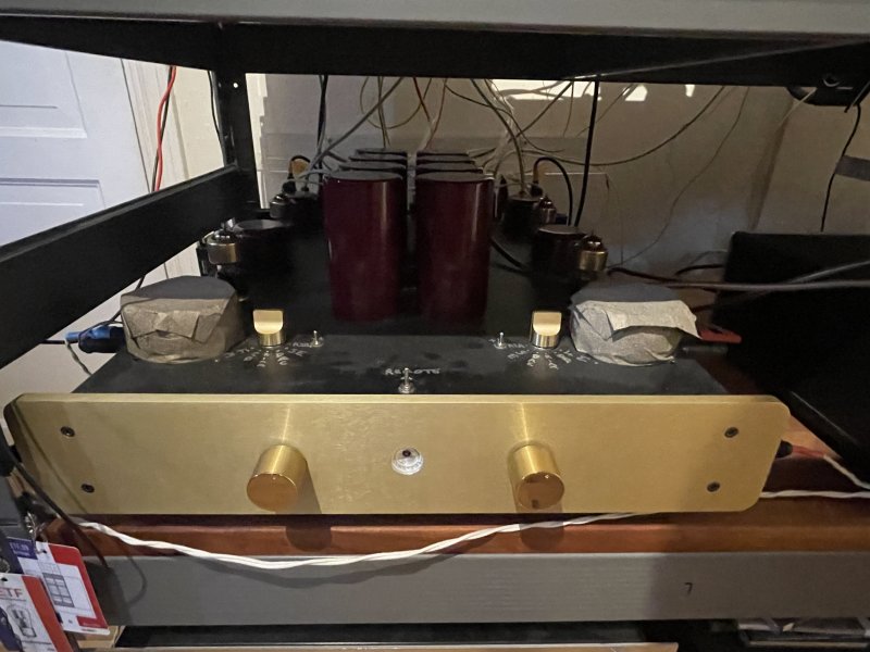

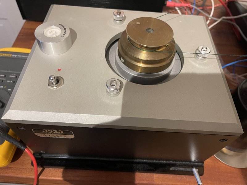

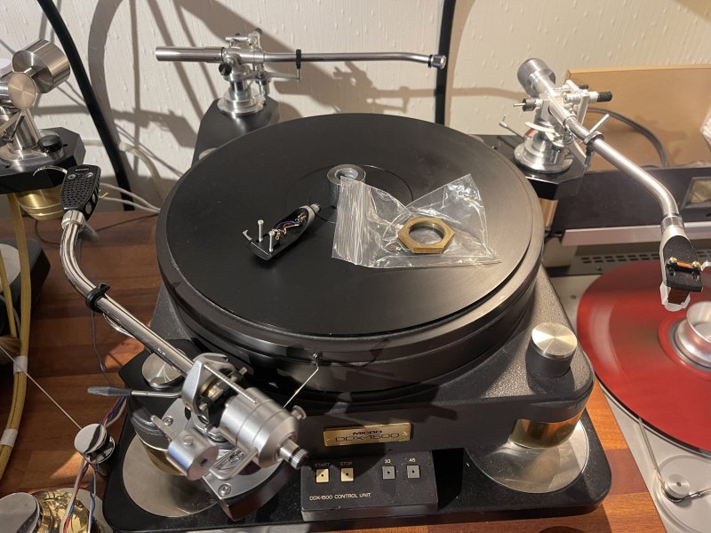

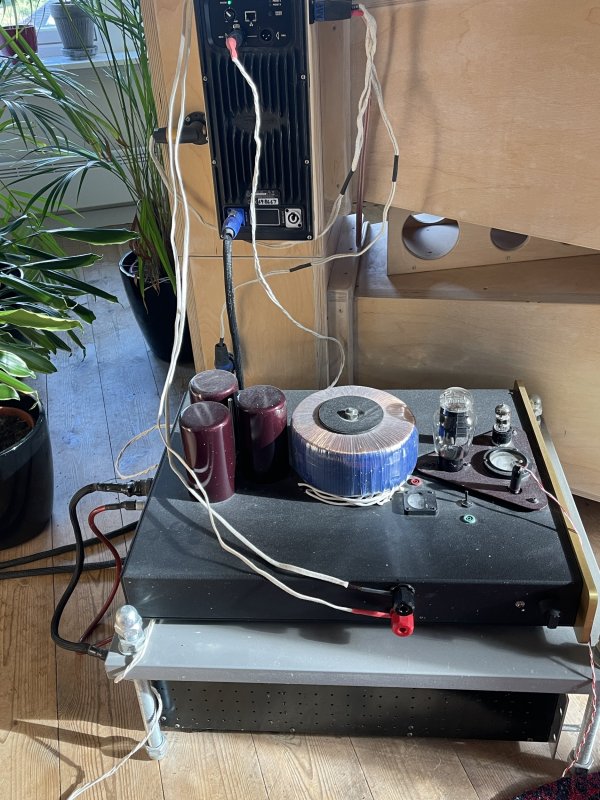

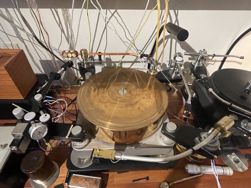

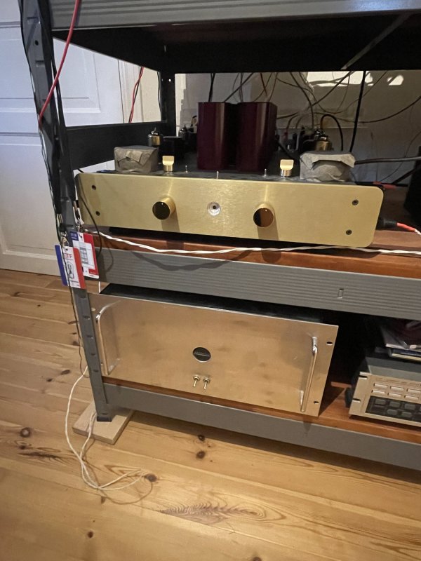

first batch from picture after bronze adapter all is in separate machine room behind system

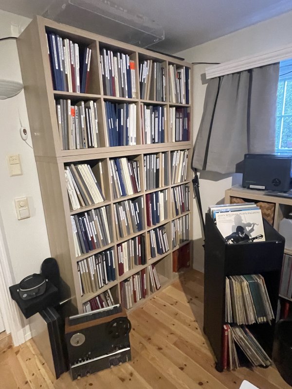

second batch

Hi Leif,
I’m feeling anxious just imagining how much time and effort you had spent making all the custom parts of your system.
Question: what platform and footers Melco is sitting on?
I have Revopods under Melco, but they did nothing reg mechanical feedback
then I placed the MDF shelf on Rubloc Trisolators and problem solved
I´ve used theese for years, but nobody seems interested
I also use them under Riaa, poweramps and even 2m high horn subs
I guess they´re not expensive enough to catch any attention, but they´re designed for industrial purposes and shipping/offshore installations
can be bought here:
they come in 3 layer about 10x10 inches sheets than can be cut into 4x4 pieces (about 1,5inch square)
available in soft or hard
plate scissor or even carpet knife will do....
Thanks, I’ll give it a try,even though I don’t have any feedback. Just thinking of improving on stock SS feet performance
BTW, do you use soft or hard ones?
25-40kg ish soft
over hard, but you can adjust by using 3 or 4 under cabinets
I would try under 817s and Rada
hard under Melco...a sheet costs about 300EUR and will cover at least 6-7 clients
