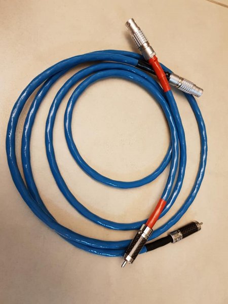

What phono cable are you using ?
Has the cable manufacturer followed Gryphon's instructions exactly ? Details are in the Owner's Manual. Connection is slightly different from normal.
Hi Philip,
The tonearm cable is a Gryphon Guideline terminated by the dealer. I've changed the tonearm cable during troubleshooting and ascertained that it is not causing the problem.

Yes! Picture of my tonearm cable. Also used my dealers cable and still same hum. The Legato Legacy is dead quiet at his place.
