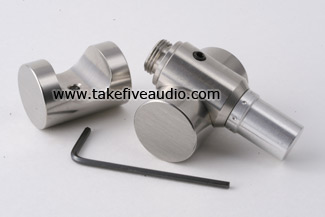

The Rega arms are notorious for needing more weight because the VTF is a spring that lifts the arm requiring. That changes the vertical resonance of the arm depending on the setting. For the Rega arm, I like using the Mitchell Technoweight, dialing in the VTF at around 3g, and then setting the correct VTF by moving the weight. Depending on the cartridge (sometimes cartridges have different vertical and horizontal compliances) adjusting the zero point may reduce a brittle/hard sound or tighten up a fat bass.
