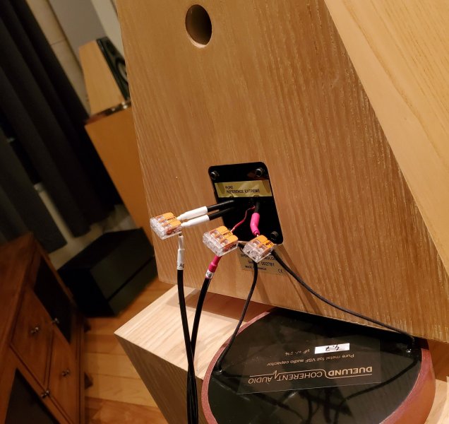

I kind of split the difference and use low mass pure copper lever clips, although if I knew my gear was in its final location I'd probably go all the way and solder. I think it's a no-brainer if the system and room are stable enough that you can deal with the inconvenience. Why put all that extra metal in the middle of the signal path if it doesn't need to be there?
My (work) computer isn't showing your crossovers, so apologies if this is meaningless advice in your use case, but one thing to note is that you might have to do some sealing around the wires where they exit the speaker. I was getting some "chuffing" and "puffing" noises when I played loudly and had to seal the area with silicone. It was more challenging than I expected to seal the holes to prevent this. A lot of pressure inside the cabinet even despite the small pre-existing port...

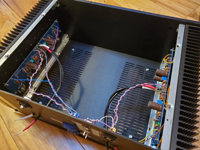

Did you note much difference before and after or did you start from scratch that way with your First Watt?

Unfortunately for both the speakers and amplifier I incorporated the binding post modification along with other changes so I can't report on the degree of improvement. Damn greedy behavior. Sorry.
But like you said, I don't care how exotic and perfectly engineered the connector is, you're just adding more metal (and micro air gaps) to the signal path. It has to be better to go direct.
