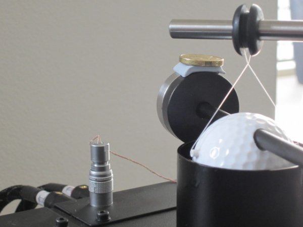

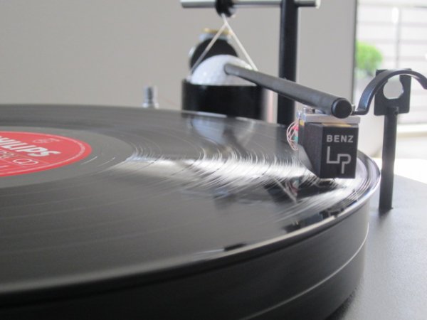

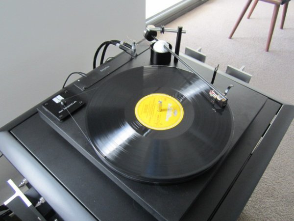

Here are a couple shots of yon beastie:

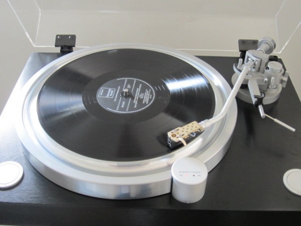

And this is what it replaced...28 kg of Japanese 1980's muscle deck, which was also around 2k imported from japan + another $280 for an outboard psu. Excellent deck as well although not as quiet as the WTL.
