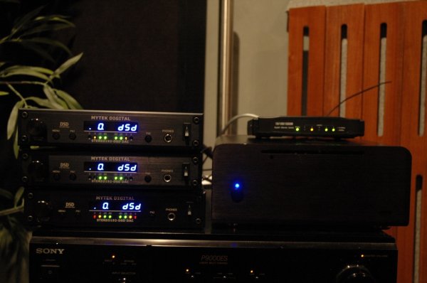

Here's what the setup looks like (stacked Myteks next to my CAPS V2+. The other thing is simply a gigabit ethernet switch, so my 2 channel setup would still have ethernet).
