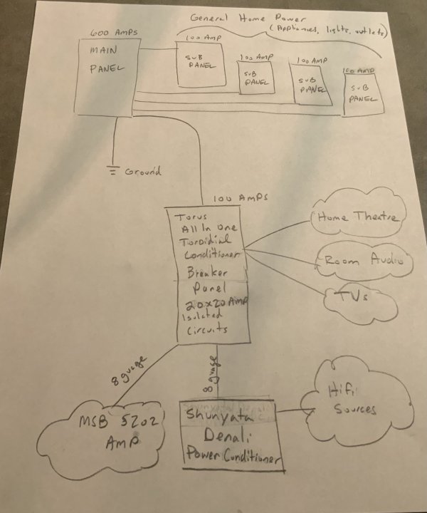

If you wouldn’t mind, please take a look at my current electrical power configuration in the sketch attached. Will illustrate what I’m currently working with.
I’m not an electrical engineer but I still recommend running a dedicated line (solid core) directly from main breaker board (preferably from meter) to Shunyata power conditioner and skipping Torus. IMHO it will be the best option for uncompressed dynamics. Additionally, skipping Shunyata together with Torus and connecting dedicated line to a group of receptacles might enable better sound. You need to try this IOT decide whether or not using Shunyata but Torus must be skipped in this current situation. There can not be a dedicated line or long runs of cable after a filter or transformer like Torus. This is how it should be IOT limit it’s impact on compression.
I have sold a lot of Torus and never had the reaults you talk about. You describe an installation that is not ideal.
First, the load side circuits of a Torus should never be longer than 40 feet. Best to be 10 to 25. The person selling it to you should know this. This goes for any isolation transformer.
Don't plug some other conditioner into a Torus.
I have never heard of 8 awg Romex style cable that is solid core. They are all stranded in the USA.
#8 stranded is sort of bright and fast. Not a lot of body.
Using a pigtail to size down #8 makes a mess of the circuit. Overlapping fields. Get rid of the pigtail if you can. I bet your #8 is stranded. Get rid of the pigtail and splay the wire to wrap the screw under 1 yoke
Your electrician probably drilled a single hole and pulled all 3 branch wires through it. Thats a big mistake. 1 wire, 1 hole spaced 4 to 6 inch between holed, 1 wire 1 duplex direct. No pigtails. .
I would never have sold or set up your electrical that way. You are way better off using one of those #8 and using a RM40 to power just the audio gear. Put your home theatre/TV on some other circuit or conditioner. Or get a different Torus for that.
With a RM40, modify the cord end to accept a twist lock 30A receptacle that can accept a #8 wire.
Sorry you were mislead by a salesman. A 12kva core is way oversized. And I am not such a fan of that unit. Its designed for a recording studio where its in a electrical room next to the comtrol room and all the branches were used. It had aluminum in it too. I hate aluminum.
As a wall mount, I would have put a WM45 on the wall just outside the room feeding your audio, fed with with a NM-B #8 or #6 and ran 3 x #10 solid NM-B to 3 duplex.
If you could not get the WM on the wall, I would have used the Rack Mount RM40.
I don't know who sold you the unit. I have no idea your options. I would try to get them to take it back. Its the wrong device for the job.
Reactions: SCAudiophile

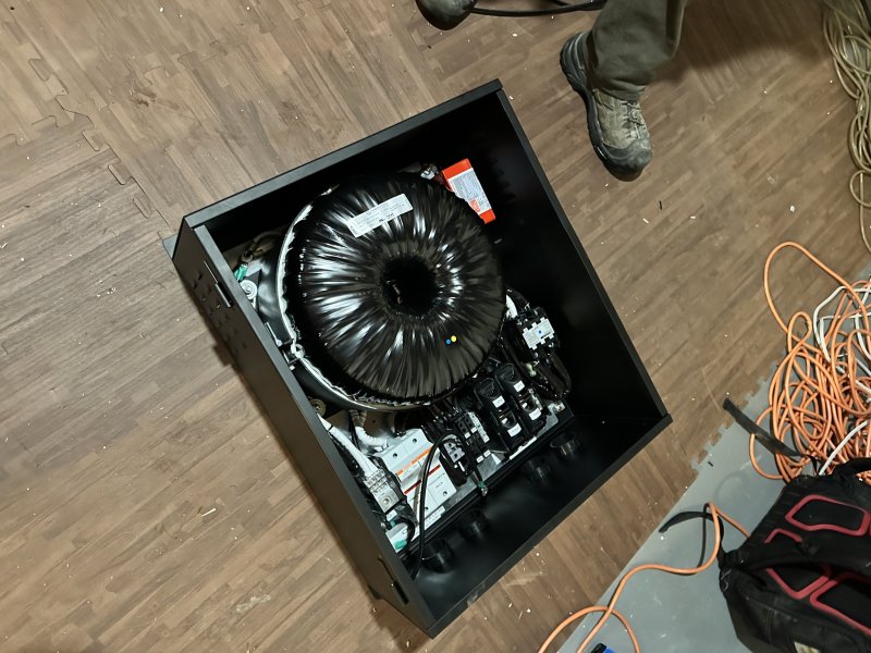

IMG_3513.jpegIMG_3528.jpegHi, all I wanted to just mention that I recently had a Torus wall mount transformer installed between my main panel and my subpanel. The results so far have been phenomenal. Blacker backgrounds bigger, sounds stage. Everything just seems more quiet and cleaner. I do still use a Stromtank S 2500 for my sources but the mono blocks , my active speakers and subwoofers are all to the wall that is being isolated by the Torus, (as is the Stromtank for that matter.) I think these wall mount transformers are legit and I highly recommend them. The team at torus is phenomenal. Feel free to reach out to them with any questions. Customer service is top-notch. Ross Whitney is super helpful and knowledgeable!
Reactions: KidTurbo
View attachment 137956View attachment 137957Hi, all I wanted to just mention that I recently had a Torus wall mount transformer installed between my main panel and my subpanel. The results so far have been phenomenal. Blacker backgrounds bigger, sounds stage. Everything just seems more quiet and cleaner. I do still use a Stromtank S 2500 for my sources but the mono blocks , my active speakers and subwoofers are all to the wall that is being isolated by the Torus, (as is the Stromtank for that matter.) I think these wall mount transformers are legit and I highly recommend them. The team at torus is phenomenal. Feel free to reach out to them with any questions. Customer service is top-notch. Ross Whitney is super helpful and knowledgeable!

Hi Rex, et al,
My sincerest apologies for my late response to your thoughtful and descriptive message. I haven’t been on WBF in months. FYI- this is the same Blake with whom you’ve been corresponding via email regarding sub panel selection.
I’m very disappointed to hear how I was misled into implementing the Torus AIO for the wrong use case. And, even if it had been the right use case, it was not applied correctly for the reasons you point out. Sadly, I likely have wasted $50K between material and labor cost pertaining this “wrong implementation”, and to add insult to injury, it is likely also degrading the sonics of all my meridian audio ceiling speakers and home theatre speakers that are home run to it. Alas, we live and learn.
Given your feedback and others, and my conclusion that my 2-channel sounds better plugged into a general house duplex vs my current dedicated AIO circuits, on Monday the electricians will be at my house for a week long undertaking the following project to bypass the Torus AIO in the delivery of power to my two channel system. The scope of the project below reflects input from MSB and your recommendation regarding sub panel choice:
- from my 600A service entry SQ D distribution panel, I am running a 125A 120v 1/0-1/0-1/0 + 8 AWG ground circuit (all conductors will be individual wires) to a sub panel (running the extra hot, will allow me to add a 240v isolation transformer in the future) in PVC conduit; may run an isolated ground too though most of the white papers I've read do not say this helps sonics
- Was hoping to source a bolt-in sub panel that could be recessed in a 16 inch stud bay; however, the only sub panel that meets that spec according to you is manufactured by Benjamin Electric. However, it's a $7K investment and have heard that the cost doesn't warrant the "improvement". Given this, have consulted Rex and a couple consultants who recommend SQ D's QO panel. They seem to prefer this line over Eaton's CH line. Unclear why.
- as an aside, I did see Shunyata's white paper that recommends hydraulic electromagnetic breakers, but I don't know whether they are worth the cost or even compatible with the QO or CH sub panels?
- Three 25-30' 120v 20A circuits will run between the sub panel and my listening room GTX-D NCF rhodium duplexes. As planned, these will be 8AWG romex runs; however, I understand that you prefer 10AWG. I could run either gauge and wish I knew which gauge would provide better sound for my components. MSB prefers 8AWG for this length of circuit. Besides yourself, if anyone has tried both gauges and has an opinion, please weigh in!!!! I have cryo’d 10 AWG romex already on hand and heard about Audience’s in wall wire. I’m happy to spend a few extra bucks on the latter if it’s worth it.
- If I do run an isolated ground to the duplexes, it as planned will be 8 gauge.. Of course, all wires will be cut to the same length
- amp will plug into the wall, while my other components into a Shunyata Denali 6000v2. I also own a SilverCircle 5kVA SE isolation transformer power conditioner into which I could plug my amp and/or Denali. Let me know if you or other folks have an opinion.
- MSB likes a thin layer of sliver paste while some don't...wish there were consensus
- all hot and neutral conductors in circuits will be twisted ~6-12 inches per MSB's recommendation (this will be a best effort given the size of the 1/0). Ground wire will be left untwisted. Question: for a 240v circuit which of the conductors (ie, two hots and one neutral) should be twisted and which should not?
- I am considering installing a 25KVa Trystar Isolation transformer as the 1/0 circuit enters the sub panel, but this will come in the future. A wall mount isolation transformer will not work in my case.
- I may add some supplemental ground rods...we will see
Rex greatly value yours and others’ feedback to my scope. If I am to make changes to the latter, I need to let my electricians know asap!
Thanks,
Blake

1. If my main 600A SQ D distribution panel is not an I-Line Series, consider swapping it out
2. Do not run individual 1/0 conductors. Instead run 1/0 SER wire. Some clarifying questions:
(A) Is the noise canceling geometry of the SER cable as good as twisting individual 1/0 wires? My understanding is that all the wires within an SER jacket are twisted together, including the ground wire. Isn’t the ideal geometry having the hot and neutral conductors twisted with the ground wire free and loose?
(A2) if pulling SER wire is too difficult, I assume you would be OK running manually twisted individual 1/0 wires?
(B) when you say NO PVC conduit, only use steel…are you referring to the conduit for the SER wire or for the isolated ground? Or both? My understanding was that PVC is better for long circuits since steel conduit could interact or generate inductance on the circuit
(B2) if it meets code, can SER wire be run outside of conduit?
(C) would you use the ground wire in the SER jacket as a safety ground while using the ground wire in the separate steel conduit as an isolated ground for the duplexes?
(D) If I told you that I don’t have the ability to add a second conduit to pull a second SER circuit to create a 240v circuit in the future, could I still adapt the conductors in the single SER wire to deliver 240v without much sacrifice?
(E) if I’m going through all this trouble to run this SER circuit, for your money, would you increase it to a 2/0 SER wire considering this circuit will be around 200 feet?
(F) Stating the obvious, I assume there is no need to twist an SER wire to improve noise cancellation.
3. You recommend running an isolated ground to the sub panel and duplexes. Some clarifying questions:
(A) for the isolated ground wire running from the service entrance panel to the sub panel, how far should its steel conduit be from the conduit containing the SER wire?
(B) what gauge wire should this ground be from the SE to the sub panel? From the sub panel to the duplexes?
4. Regarding sub panel selection, sounds like you are still recommending the QO given my time constraints
5. You strongly recommend cryo’d 10AWG (vs 8AWG) a 30 foot run. Question:
(A) should the safety ground wire in the romex jacket be twisted with the hot and neutral conductors? If not should it be removed and run outside the jacket?
(B) if code does not require it, should the duplex circuits be placed in conduit? How about the isolated ground wires running to the duplexes?
I’ll email you separately about how I ended up with the AIO.
THANKS AGAIN!!!
I think I gotta start over.
SER cable is service entrance rated. It's like a big romex cable. It takes no metal or PVC raceway. It's extremely easy to pull from one place to another.
The geometry isn't so much about noise rereduction. You have to twist tighter than you're ever going to twist 1/0 to reject noise. It's more about keeping even inductance and capacitants.
I was asking if your panel was ILine, or just a NQ panel, because ILine panels are highly configurable. NQ Panels too but its much harder to get the parts. Leave it alone. Its a good foundation. Would not hurt to remove the feeder breaker to the subpanel and deoxit clean the feet and bus. Same for neutrals and grounds terminations.
Run 2 raceway of SER. Don't get an extra wire and feed a second something while sharing a neutral and ground with the first fed device.
And why 1/0. Its a stereo. #2 is usually the largest I spec. #4 NM-B is excellent as it has a solid #8 ground. I lost where you listed your system. If its multiple rooms with multiple systems, then 1/0 makes sense. And also why a Torus pounded with that much noise is the wrong piece. Dedicate a Torus to 1 system.
Isolated grounds.
If you run wire in a steel pipe, a isolated ground can be beneficial. If you run wire in a PVC pipe, the isolated ground has no benefit at all. What are you isolating. Nothing.
I like PVC, NM-B, SER raceways. Art K like steel raceways. But like I told you in a PM, he's servicing a different clientell.
How many KVA does your Torus have? Just curious.
Hi! It’s the WM-208-240P-2x120S-14.4K-TVSS model , and i believe the 14.4 also is the kva; my understanding is that In practical terms it’s two phase of 60amp each . The team at torus will go through all your gear and calculate which unit fits your needs best; I went a bigger model because I have a lot of gear in my listening room and wanted overhead in case I upgraded in the future.
