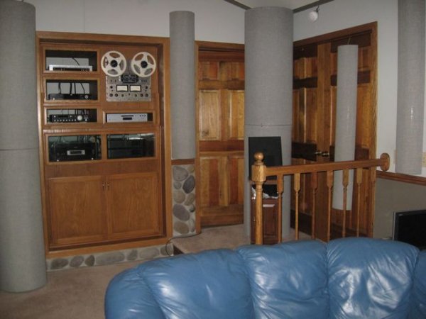

ASC tube traps
Using ASC tube traps makes a huge difference with bass transients and quality of bass. All corners from floor to ceiling
have large bass traps, as well as mid points. Around the entire room I use mid range tube traps, which are 3 feet apart.
Midrange clarity is superb and spatial imaging is wonderful. All these traps (35 traps in all) have a reflective surface
on one half of their surface that can be rotated and provide excellent diffusion of high frequencies.
It takes many bass and midrange traps, but it does wonders for smooth bass, clarity, imaging with great depth.
The overall difference is enormous and the added benefit of a very quite room.
