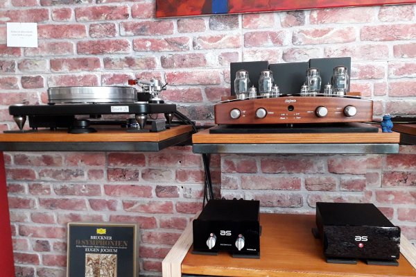

Here you see fine combinations with nice designed record players in an elegant interior. VPI Scout and Bergmann Magne.

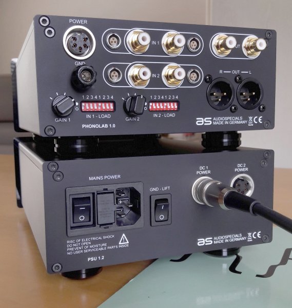

The AS Phonolab 1.0 from Audiospecials combines both. Modern timeless and puristic design on the front panel and if you turn it around, just the opposite. Two inputs for two record players, balanced inputs and RCA, 4 Gain steps and many different loadings. There is no cartridge on the market that won´t fit. No matter if MM or MC. The Ortofon´s SPUs like this phonostage very much because of its huge range of extra low Input loadings down to 15 Ohm.

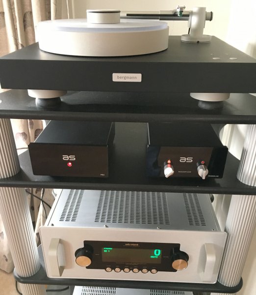

The "pure Design" refers to a minimalistic front panel design although the front panel implies 5 functions. Two knobs (Recompizer), two LEDs as an indication for the Inputs 1 /2 (left /right). Plus a hidden" invisible touch" sensor beside the left LED, to switch the inputs over. That´s probaly no coincidence that the owner of the Bergman chose the AS. A nice couple.
