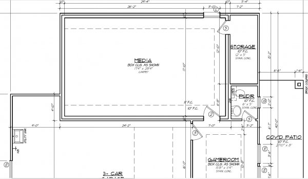

So I purchased a lot, IMG_6063.JPG1.1.jpgmade an initial drawing of the house, and then asked people's opinions, while refining the design for nearly a year. Then I needed a builder and I found out that it was a very tricky business. I "worked" with 5 builders without actually starting the construction and signing a contract, before finding one to my liking. I wanted one who would be honest, experienced, available for his time, and would not rip me off. Most importantly, I wanted a builder who would work with me at a very detailed level not just on the audio/media room but the entire house. Picking the final builder took more than a year.
I made all of the detailed drawings of the house myself, including every tiny detail that my untrained brain could tell. This included everything, including bathrooms, windows, doors, wall thickness, fire place, front, back, sides, roof, closets. Finally hired an architect to verify everything, ensure all of the city code requirements, and create the blueprints. She suggested a few minor adjustments and the design was approved. The construction started in May 2018. Will post pictures here of step by step.

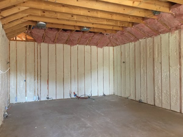

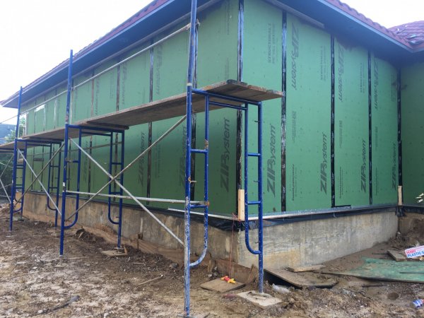

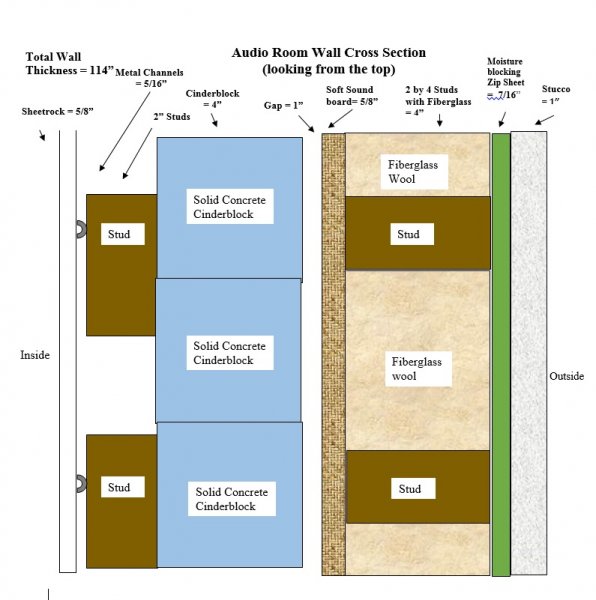

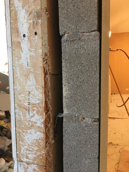

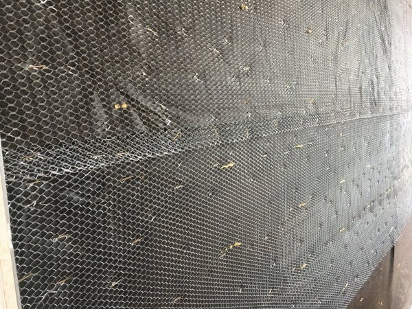

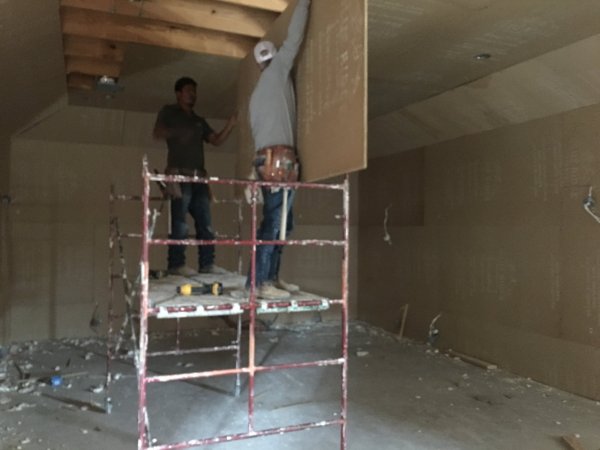

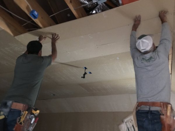

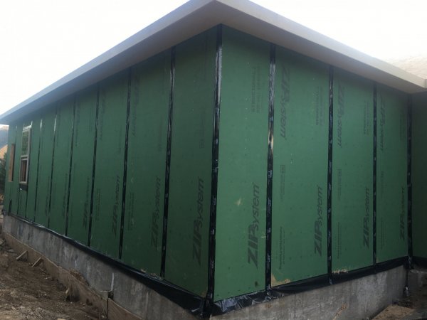

The final was design (from outer to inner layer): Stucco, metal screen, moisture blocker, 2x4, insulation, soft sound board, air gap cinderblock, MDF.
Excellent! These wall structures can be very complicated. (Ask me how I know. :D)
So from the inside the sound waves are “seeing” soft soundboard and then air gap and then cinder block? That seems good to me.
No, the other way around.
I listed he layers starting form from outer to inner layer! So the MDF is the inner most layer, which is nailed and glues to the cinderblock, then air gap, then soft board. However, there will be diffusers too attached to the MDF walls.
Interesting. What is the acoustic objective of the air gap on the far side of the cinderblock? (Or is that just a construction element?)
The gap is purely for the acoustic objective of isolating layers to attain sound proofing, to prevent leaking and to contain the sound within the room, especially the bass. It is analogous to a thermos bottle, and is perhaps the cheapest way (material wise) to prevent the sound from travelling between layers. In another analogy, the room is like a (multi-layer) balloon full of air when filled with bass, and unless sealed, it will continue to leak air. Gaping is a highly effective in preventing that. My goal in construction was to first prevent the leakage of the sound energy. After that is achieved, then what do you do with the so much energy left is another matter.
