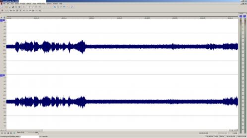

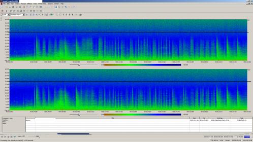

The client wanted me to check to see if I got the same findings on all the files they had submitted. We had sent 2 sets of files to Naxos for distribution to 7 or 8 Content Providers, a DSD file and a 176.4 FLAC file. I downloaded 2 albums from each DSP from the US and EU in 176.4kHz FLAC. I was not prepared for what I found!
To begin with, I only checked the first track of each album to keep it simple. I ran a statistics and spectral analysis and this is what I found.
Original file size 217MB
DSP 1 file size 263MB
This one was the largest file size. Also there were 2 glitches (arrows) in the music. All of the other files were fine. Sound was kinda' dull and uninvolving. Content does extend past 30k. RMS about 1dB lower than original. WTF??
DSP 2 File size 145MB
This one sounded much better... closer to the original file. Content only extends to 28k though. RMS 1dB lower than original.... Zero Crossings only at 2,600 ? WTF??
DSP 3 file size 217MB
File exactly like the original Totally untouched! Note Zero Crossings at 28,000
DSP 4 file size 148MB
This one was pretty much like DSP 2. Sound was Ok...
Final Analsys:
1. DSP 3 seems to be the only one holding true to the original file.
2. Whether Naxos is doing it or the individual DSP's, someone is mucking around with your files. You can see the different file sizes, which means they are using different data compression
ratios for the FLAC files.
3. Also whatever they are using is altering the sonics because of the different loudness, which is audible. You can see this by Min/Max Sample values, RMS value and such.
4. There are different filter algorithms, taking out the noise compared with the waveforms of the original/DSP 3 and the others.
5. I’d also have DSP 1 pull that file and correct the glitch
I work my a$$ off trying to provide consumers with the best available downloads possible. I can't believe all my hard work has been screwed up by these a$$-hats.
