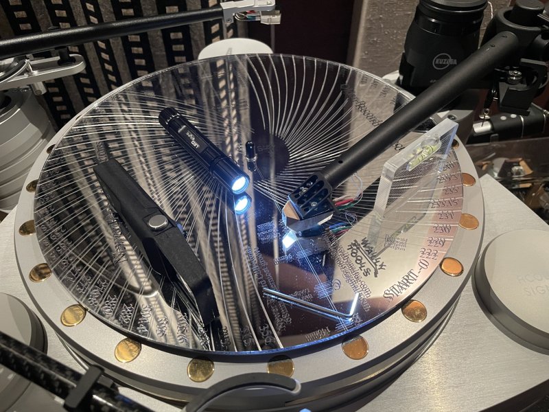

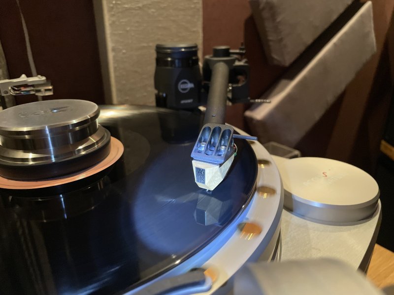

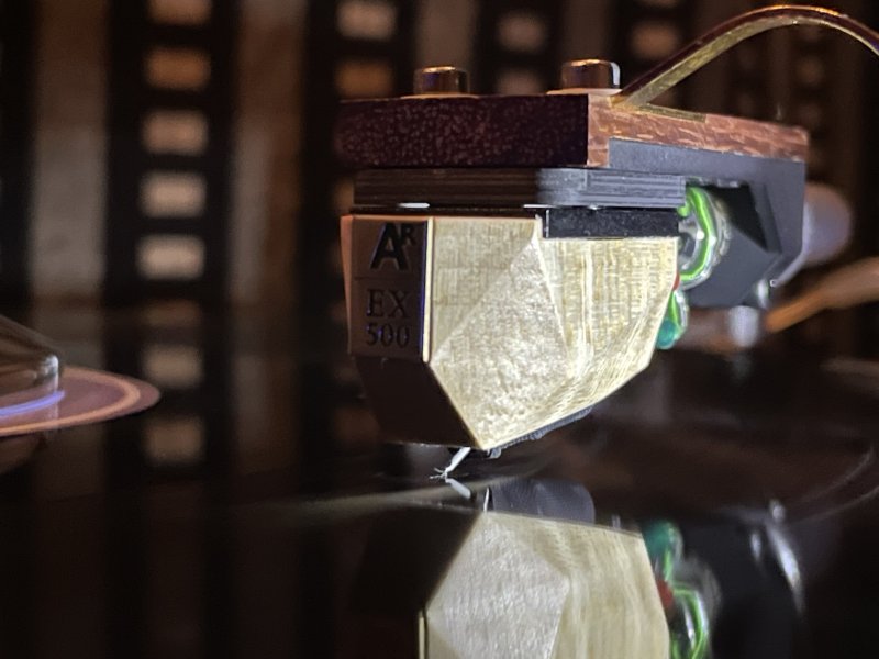

The Analog Relax EX-500 did all of that to me yesterday and I couldn’t stop playing vinyl. The setup was pretty straight forward and quite easy to align due to the visibility of the cantilever and stylus. The headshell / cartridge combo weight is just over 29,02 grams and to my experience just perfect to get everything balanced. Tracking force is set to 2,0 grams due to the manufacturer’s recommendation. It seems very right to me aswell, so no change there. The tonearm is 100% perpendicular to the vinyl surface, and sonically no change is necessary there aswell.
The EX-500 MC cartridge is going into the AirTight ATH-2 Reference SUT and in to the MM input on the D’Agostino Momentum phonostage with a total gain of 67dB. Load is set to 31K Ohm, as 47K was sounding just a bit too bright for my own taste. 31K just calms everything down to deliver a perfect experience. At more than 0,5mV, the EX-500 delivers a mighty powerful punch in it’s presence, with a very natural ”Relaxed” quiet background when the stylus hits the grooves but still no music.

It seems you’re using some spacers between the cartridge and headshell. Are these ‘’just’’ for alignment to get your arm level as you mention? Or do you also use them for sonic reasons? If so, what are they? And how do you feel the improve sound?

Yea I normally use some spacers on the SL-1200G for greater mobility on adjusting the tonearm. It all comes down to the design of the cartridge body, how well it fits in the headshell and such. For me they are spacers, and not for sonic improvement in their own right. However… by adding any mass on the headshell side, you need ofcourse more counterweight to balance things out and ’that’ has a sonic effect. Hope that helps.
