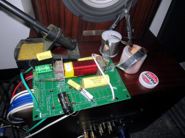

Designing a new loudspeaker is not something that's done overnight. First, all the calculations to get to a crossover that would theoretically be "perfect". Easy enough.
Next, comes hours and hours of listening and adjusting the crossover. Capacitor choice and inductor orientation makes a big difference in the final sound. Does it sound better to use a 4.7uF 400V cap or a 4.7uF 600V cap? How about a 4.5uF cap paralleled with a 0.2uF cap? Inductor with the signal running clockwise or counter-clockwise?

This is what "work in progress" looks like. I solder components on and off the board when music is playing - which means that any amplifier I use must not only drive any loudspeaker impedance load, but must recover from a short circuit without blowing fuses.
