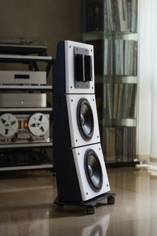

Kind of dark out for good pictures.
Reactions: flat4

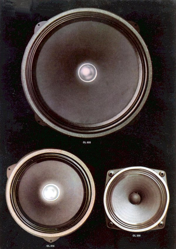

With altec must be ported, I have to say I made a mistake. In the video, I thought they were Altec 421s, but they weren't. They were Heco OL 410 bass drivers. They look totally similar diffrent qts valvue...sorry
Altec
Heco ol410
Altec
Heco ol410

I tried a couple quick wings last night. They were too tall. Boards from a armoire. They were a bit tall and extended half way up the coax. It had a dramatic affect on soundstage. Chopped it out. I did not notice any added bass. Very rudimentary. I need to take a better try. It was just parts sitting around.
During the test, the subwoofer was switched off.? Clearly, if the side wings limit the angle of the rearward sound of the coax.
Tell me, can you change the configuration of the elements? Are there holes in the frame then you put the coax on top? Then you could use the side wings for both bass drivers more effectively
I could imagine that the standard frame and you can use other mounting holes for other driver configurations.
