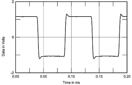

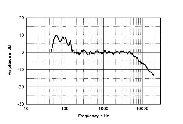

OK Professor Don, what challenge does this present for an amplifier? Link 621MagA5fig2.jpg 621MagA5fig3.jpg

OK Professor Don, what challenge does this present for an amplifier? Link View attachment 101269 View attachment 101270
I assume the bass hump in the frequency response is either by design or an artifact of the measurement system (it is hard to measure bass response in a room unless it is anechoic down that low). Interesting the highs roll off over 10 kHz, probably a design choice. Pretty flat across most of the range aside from the little narrow dip around 4 kHz. I'd guess they sound good, not that my opinion matters!
Moving on to the impedance plot, and bearing in mind speakers are not my area of expertise, this one seems challenging. Impedance below 4 ohms much of the time, and a little below 3 ohms around 100 Hz where there is also a pretty big phase angle that probably drops the effective load to below 2 ohms. Ignoring the low-frequency peak around 45 Hz, there is fairly broad 9-ohm peak around 2 kHz, so you have about 3:1 (9.5 dB) variation in impedance over the frequency band. (Note that does not translate to a 9.5 dB variation in frequency response; much of that is probably from the crossover, so the acoustic output is still flat.) A tube amplifier will likely modify the frequency response, which may or may not be pleasing to you (the listener), and it'd be nice to have one with a 2-ohm tap. Even a SS amp is likely to balk at this one; definitely need one good at driving below 4 ohms. That said, outside the nastiness around 100 Hz and overall low impedance, it does not look horrible to me, just low impedance that makes it hard to drive.
As an aside, a ported speaker will have an impedance dip when the port resonates and the drivers "freeze"; since this has a big peak, I am guessing it is a sealed system?
Looking at your link, I see JA felt the same:
"Using Dayton Audio's DATS V2 system, I found that the impedance magnitude (fig.1, solid trace) did average around 4 ohms, with a minimum value of 2.6 ohms at 93Hz. The electrical phase angle (dashed trace) is occasionally high when the magnitude is low. For example, there is a combination of 3.4 ohms and –50° at 70Hz, a frequency where music can have high levels of energy. The EPDR 1 drops below 2 ohms between 53Hz and 120Hz, with a minimum value of 1 ohm at 70Hz. The A5 must be used with amplifiers that don't have problems driving 2 ohm loads."
He also notes the bass hump is an artifact at the measurement, so I was not totally out of line in my comments.
Them's my guesses, FWIWFM - Don

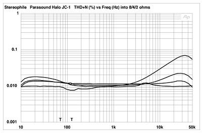

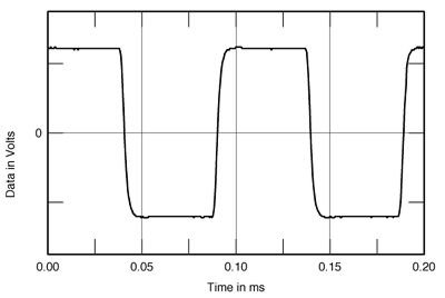

As audiophiles are wanting to do. I now have settled on a speaker. I try to mix and match an amplifier I like with no real idea if it's a good technical match for.
Parasound Halo JC 1 monoblocks. they have been around for a while, have a good pedigree and sound good. Let's see if they can handle this load.
Link

Technically the JC1 looks like a great match. Maintains low output impedance past 20 kHz, handled a 2-ohm load with prodigious output power, low distortion, and decent SNR. Seems like a winner, hope it sounds great!

Fig.3 shows how the THD+N percentage varies with output power into 8 and 4 ohms (but not 2 ohms, due to the amplifier having problems driving loads below 4 ohms)
