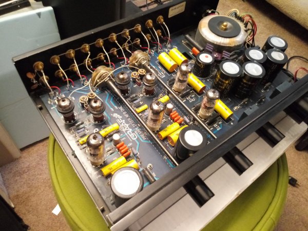

own a tube preamp that I bought used in late 1990's.
Have replaced four E88cc (6922) tubes about every 8-years, never replaced the four PC900's in the med/low phono section (that I can recall).
The replacement tubes have been two in the main line section, and two in the phono hi-gain section.
I have never experienced noise/grain only excessive heat, loss of both channels or weak channels in either R&L that migrate randomly between R&L prior to replacement.
These failings happen in both CD and LP playback, not just one or the other. In other words, in the line stage.
I have always used the medium phono gain at 47k for MM cartridge. Never used a MC and do not plan to.
Question: from the diagram in lower left, the two tubes labeled "phono hi-gain", do you think these are in any way active when using a MM?
Reasoning: if these tubes have never been used then I perhaps can rotate them into the line-stage section, right?

The question is simple, when using MM, are the two 6922's in the "phono hi-gain area" engaged and being worked?
I was thinking (please correct me) hi-gain would be employed when using a MC cartridge via the higher gain settings available with internal switches.
If true, then these two tubes in question have zero hours on them and need not be replaced. They can in fact be used where needed, in the line stage - in theory.
Asking, not stating as fact.

I'm not 100% certain but the two 6922's labeled "phono high gain" are likely the for the MC gain stage only and aren't used while low or medium MM-only stage is active.
I would give the pair a try and see how they sound.

The problem is my limited understanding of my tube phonostage(s).
The fact that 6 out of 8 tubes are related to phono signal amplification is actually something that never hit me before a few days ago. I always regarded the star grounded PC900's as my phono tubes.
What the heck is hi-gain phono?
The possiblity that the MC section lays dormant under my ownership and that even when I replaced and saved those tube before that they still might be good excites me - I love saving/recycling and reusing things and hate waste.
