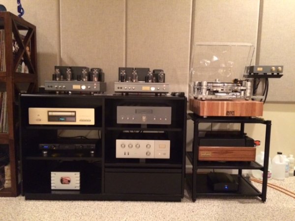

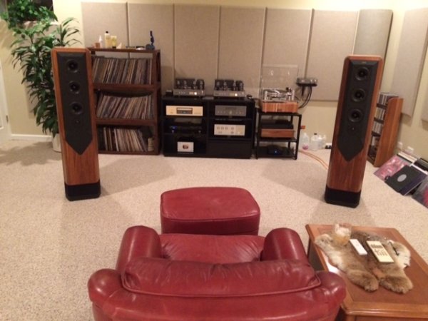

I wanted to provide some updates on the delivery, setup, and impressions of my new Oracle...
The TT was finally delivered on Wednesday. After having gone through the setup manual no fewer than 10 time, when I finally opened the box/packing (packing was exceptional) I didn't encounter anything that I was ill prepared for. I took my time, followed the instructions to the "T", and had everything finished and my arm/cartridge geometry pretty close to “spot-on” within three hours. I then connected it to my system, leveled it and adjusted my arm height and weight, and then set the azimuth using a Fozgometer. I then played a couple of my "reference" LP's to dial in the VTA. So my initial impressions from the past three days of listening.... stunning!
The first thing I noticed was how quiet/black the background was and the positioning of instruments/voice throughout the sound stage. Comparing it to a "visual" experience, it was akin to putting on 3-D glasses! Additionally, I was amazed by how "pristine" everything was across the entire frequency extreme. The highs were gorgeous without any glare or sibilance and the articulation of the bass was equally impressive - tight, full, and deep. Last night I poured myself a glass of Maker's 46, went down to my listening room, turned off the lights, and cycled through an assortment of all of my favorites - old and new. Five hours later, and a couple more Maker's, and I was in musical nirvana!
I can't wait to receive my new Graham Phantom Elite and see what incremental changes/improvements the new arm makes over the 1.5TC - although I could certainly live with how things sound right now.
Here's a couple of pictures for those interested...

Congratulations on a stunning setup. I can certainly agree on the packaging as I experienced the same with the Paris I bought. I also thought the manual, which I also read several times prior to getting to the task of doing the install, was excellent and easy to follow. Unfortunately I'm having some issues, but I won't pollute your thread with that.
Enjoy your new Oracle Delphi......she's a beauty!:D

I can taste that maker's 46 right now ! What a lovely listening room, great equipment choices and a NICE chair ! I've heard the air tight cartridges a few times and I'm very fond of them...
I could be totally anal andy here and wrong about my assumption, but I might store your records on the right wall more upright...and close to 90 degrees as reasonable...they could warp over time...more like the bottom shelf on your record rack..

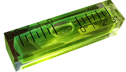

In using Adjust +, it's a bit difficult getting that little bubble level properly positioned on the headshell (and ensuring each subsequent measurement taken has the level in the exact same position - I'll be making some "alignment" modifications/additions to this bubble level so that I don't run into this issue for future measurements). Kyle
Re: Adjust +. Love the You Tube video that makes set-up look a little easier than it actually is. For measurements instead of the bubble level, I'm using an AccuMASTER digital level (https://www.amazon.com/Calculated-Industries-7434-AccuMASTER-Inclinometer/dp/B0148M7P4O) sitting on the headshell for a more accurate reading. It's a little heavy as is, so I took the 2 AAA batteries out of the unit and wired them outboard to a battery holder to make it lighter so it won't damage the arm or headshell. It's light enough when sitting in the armrest and it's the smallest one I could find. It measures to .03 degrees accurately which is perfect and doesn't suffer from parallax errors. It's a little klugy and still has some placement issues plus there's a magnet on the bottom could be annoying. Use it for the TT too. Might be worth a try - it's cheap.
Someone should design a small one of these for audio sell it for $100. They could sell hundreds and make some money.

Yes one needs to get the "extra cost" Adjust + Bubble level for some( Kuzma) arms the metal one included is useless on anything other wise perfectly flat head-shell.
