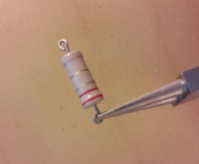

R8 and R9 are the output tube cathode resistors - they can burn in case of a defective tube. If you do not have experience with repairs, do not attempt to remove the resistors - just cut the wires as close to the old resistor body as possible, leaving as much as possible of the wire, and prepare the new resistors as shown. Then solder the resistors, inserting 2 mm of the left wire in the new resistors rings. It does not look nice but it is very often the best way to service old equipment. All IMHO, YMMV.

Hi Microstrip,

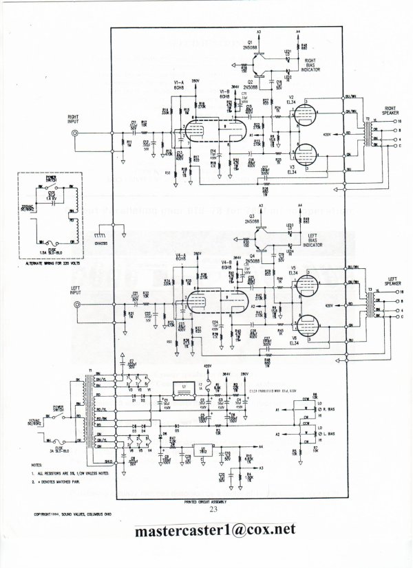

Thank you for your help. I am not the sharpest tack. Could you please tell me what resistor to replace it with? The schematic says 1 watt but the one on the board looks like it says 3 watts

The resistor will dissipate around 50 mW - a 1 watt one is more than enough. Do not increase it - in case of a problem the resistor works as a fuse. If you increase the power of the resistor you can risk burning the output transformer in case of malfunctioning.
If the amplifier is being used with common current tubes I would change the grid resistors R22, 23, 42 and 43 to 100 kohm or 82kohm. Unfortunately most modern tubes have higher grid leakage current than the NOS types and became unstable with high value grid resistors such as 270kohm.
I had an amplifier sharing a similar circuit with 220 kohm grid resistors, and although it worked fine with NOS selected tubes, it was a nightmare with russian and chinese modern tubes.
The coupling capacitor has a value high enough to support this change.

If the amplifier is being used with common current tubes I would change the grid resistors R24, 25, 44 and 45 to 100 kohm or 82kohm. Unfortunately most modern tubes have higher grid leakage current than the NOS types and became unstable with high value grid resistors such as 270kohm.
I think you mean R22, R23, R42, and R43...
Thanks - I really should wear reading glasses when looking at schematics ...

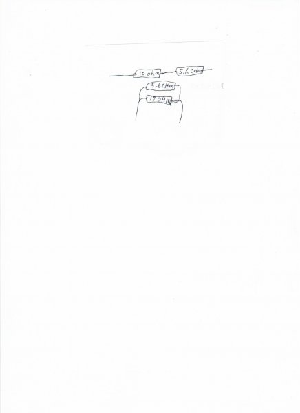

I shopped Ebay for a quad matched set of Electro Harmonix EL34's. They were $16.00 each. I purchased a matched pair of 6GH8A tubes for $6.00. I purchased 5 each 15 OHM resistors that are 1 watt 5% for R8 and R9. Will these work? I purchased 100K OHM 1 watt resistors for 22, 23, 42, and 43. They were $2.69 for 5 each with free postage. Are Carbon film a bad choice? I do appreciate your help. Once I have the parts in hand the repair should be easy enough. If I can successfully build a Van Alstine Preamp kit, I should be able to do this. I purchased 10 ohm and 5.6 ohm 1watt metal film resistors. How do I best install them? the top one or the bottom one. Thank you resistor install 1.jpg

I installed 15.6 ohm 1watt carbon resistors in 8 and 9 along with the new tubes. Sounds as good as new. Thanks for the help.
Sorry, I missed your previous post. Happy to know you managed to repair the amplifier. Surely you selected the top (series) association!
