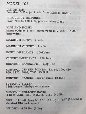

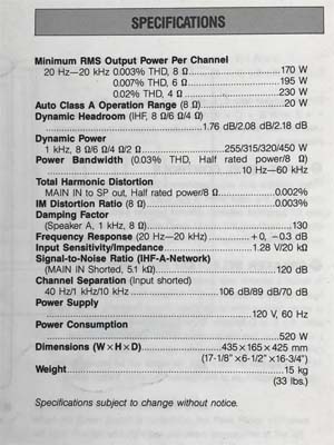

Hello all. I’m looking for a new turntable for my vintage stereo system. I have been doing some research and note that many of the audiophiles who respond to such threads want to know what the current system specs are of the OP. So, this maybe a long thread but hope to get it right the 1st time. I believe the components of interest would be the following. CONTROL/ PRE AMP: Yamaha C-85, 1988 $765 ; POWER AMP: Yamaha M-65, 1988 $720 ; REAL TIME SPECTRUM ANALYZER/EQUALIZER: AudioControl C-101, 1988 $430 ; LOUD SPEAKERS: JBL Control Monitors Model 4312, 1990 2@ $840. These components have had the best of care & although I couldn’t guess the hours on them they have never really been cranked up volume wise due to living arrangements. Since my TT had been stolen in ’87 they have probably had a 100 hours of use. See attachments for specs.
I’m looking at investing around $5K including cartridge and have familiarized myself with the following companies and models within that price range: Clearaudio, Rega, Music Hall, Project, Linn, VPI. I have also looked at several others not mentioned here. I have looked at some Cartridges but feel I need to decide on a TT first. I’m not in a big rush and would consider used (TT and/or Cart) but I really think it would have to be a guaranteed deal (possible demo, open box, etc.) from trusted known individual/dealer/certified rebuild to greatly lessen chance of fraud (however that could play out). Going the new route is simply safe but…. At this point in my searching I’m looking at the VPI Prime and something like the Zephyr MKIII Cart (read review using it) or Ortofon MC Quintet Black, but hope to avoid having to alter the stock tone arm because Cart requires a different “head shell”. Seems most recommended Carts for the Prime are also MC not MM. From my reading it also seems of benefit to go with the “Periphery Outer Ring Clamp” to this VPI Prime (saw this clamp available aftermarket cheaper).
Lots of questions but think my system needs to be evaluated by some of you experts as to what a good match would be, maybe I’m overshooting, and won’t benefit from spending this much? I have over 300 albums in excellent shape to which I stopped buying after my Pioneer PL-71 direct drive with Stanton EEE was stolen in 1987. At that time to now I have continued my music collection but on CD’s, not duplicating my albums. I would like to start playing my collection and buying vinyl again.
Besides the numerous number of TT’s & Cart selections out there since I last shopped this category I see other things. Most notable is that direct drive seems to be too expensive now and/or belt drive simply is the best option in my price range. I see in the reviews most TT’s are also coupled to a “Phono Stage”, another pricey item, but do I need this with my Yamaha Pre Amp? Then the cable questions, I have RCA jack gold plated monster cables through out my system will these suffice?
Thanks Robes :cool: View attachment 35005 View attachment 35004 View attachment 35006 View attachment 35007 View attachment 35008 5.jpg 6.jpg 7.jpg 8.jpg 9.jpg
