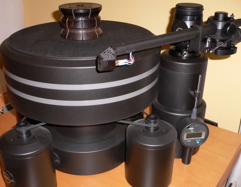

What can anyone say about this turntable he is photographed with? That's a massive armboard and it looks like passive isolation towers in a very rigid enclosure. Is this a new table design of his?
I've wondered who would be the first to design a turntable with a built in active isolation like what Rockitman just bought, the Table Stable.
I think this is just a show illustration/exploded view of the newest integrated table- the M? The older Reference also used adjustable pillars to level the top plinth as I recall, but not the turntable feet (it's been a while since i had the Reference, but it was very user friendly and easy to set up/excellent isolation without the need for external stuff- although of course, you could go there, but you'd quickly approach the cost of the table itself). The XL needs help to isolate, given its mass and lack of any suspension.
Bill, you're right about that if your floors are a little bouncy. My customer getting the XL 4 has an HRS rack and is awaiting the custom shelf and solid brace inserts for it. The floor is slab on grade.
The Stabi Reference has three feet, two at the front corners and one in the center rear, with the individually adjustable spring-in-oil suspension towers at the four corners. The Stabi M takes a similar approach except there are no separate feet. There's also quite a bit of other vibration isolation inside such as for the motor. The M is also substantially more massive than the Reference.

I received the following information from Kuzma this morning about the Stabi M: (minor edit for clarity)
The Stabi M has leveling adjustable feet with spikes in cups (similar to the original wooden Stabi turntable but more massive). Rear is fixed while front two are adjustable - so you can horizontally level the Stabi M.
