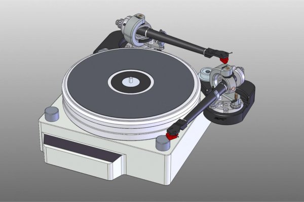

It's the angle of the armboard as he has it setup on the table, usually the armboards are in a straight line with tt's corners, wether 9"/10" or 12", in his CAD the armboard is angled to the extreme. The way he has it you lose one armpost
david
Thanks David. I get it. I will ask Marc if this angle in a must. His arm is pretty short and the round base of his arm is a least 3.5” in diameter.
I saw this position and realized I would loose one arm ever since I saw how he positioned his SAT on the AF3.

We shouldn't rush to any conclusions before seeing the armboard's dimensions and checking with Marc, it could just be the graphic. There are different length armboards for 9"/10"/12" arms, as an example here are templates for arms with 41mm diameter arm bases in 10" & 12" lengths without having to angle them.

Do you have a link to the AF3/SAT picture? What is the diameter of the section that goes through the hole?

I can tell you for a fact that you don't need to angle the armboards for a 10" Graham on the AS-2000 or any table based on Micro Seiki geometry unless they're using the same length armboard for 10" & 12" arms. I have no idea what's going on in this picture and those two arms.

You only need a 50.5mm hole for the SAT, isn't a problem for the armboard geometry.

David, for tonearms which don’t have SME-style armboard mounts or SME-style adapters what do we do? Does the tonearm maker have to machine a tonearm base hole and bolt holes in an AS-2000 tonearm clamp as shown in the SAT drawing?
Basically any tonearm will fit on the AS-2000 Ron, just need a template from the manufacturer and we'll make the armboard. We have a dozen or so templates already that will match most available tonearms anyway.

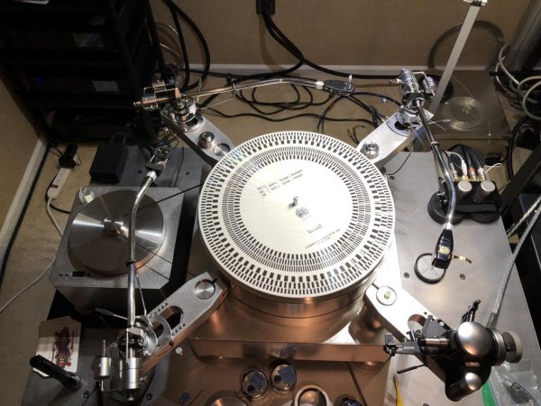

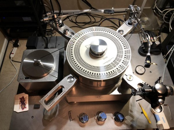

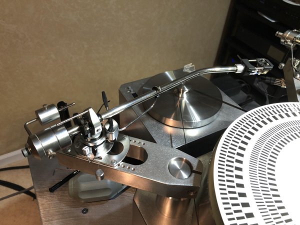

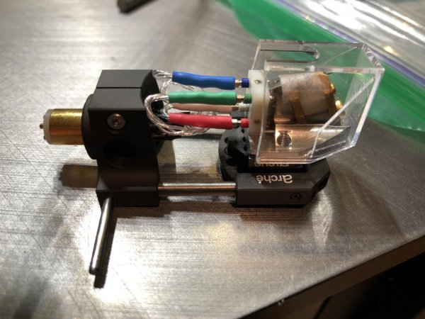

3012R #3 for the AS. Using the Arche headshell our friend Tang was so kind to send my way. The cart is a Lyra Olympos SL Mono.
