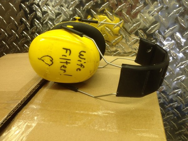

My main source of ambient noise walks up the stairs and yells at me for spending this kind of money on something she doesn't care about...anyone have any ideas?
Here's what I use. Works like a charm!!
(had to draw the heart on there so it wouldn't p*ss her off!)
