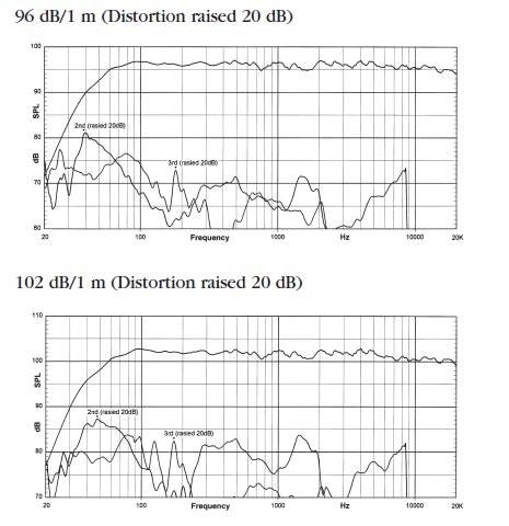

Hello Frank
You have to know where to look. I look at measurements all the time. Depending on how complete they are they can tell you quite a bit.
Rob:)

Thanks for those, Rob! So, where do we find this magical stuff, then -- are you talking about Zaph, etc?
Of interest, note how the 2nd harmonic starts to rocket up at higher frequencies; getting to around 30-40db down: not so good. When you get a cleaner graph, nudging 60dB down much of the way then you're talking of some better stuff ...
Frank
Frank you have to subtract 20db from those graphs. The legend say up 20db so you can see them at that scale. So at 500hz you are at -55Db down on the 2nd
Rob
Rob
Yes, I took that into consideration. The human ear is more sensitive to distortion at higher frequencies, and if you check what's happening above 5KHz or so, on each one of those graphs; that's where I got the 30-40dB down numbers.
Frank
