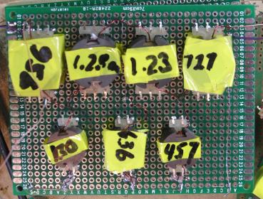

Continuation of an answer to Steven's question
The solution that suggested itself based on the experience related in the last post was to use a passive filter. At first I tried series SMT (1206 size) inductors between a simple TDA1545 DAC and the amplifier stage which used an AD603. This constitutes a 1st order filter - with about six such inductors in series I was fairly sure I heard an improvement in the sweetness of strings through this arrangement, an encouraging result. I then experimented with cheaper parts called 'ferrite beads' instead of inductors. The inductors were wirewound and about 10X the price of ferrite beads, so I tried with a dozen or so ferrite beads in series and this produced the rather surprising result of reducing the 'detail' in the sound. But with somewhat longer listening, this new 'reduced detail' sound didn't actually lack information, nothing was missing just 'details' no longer stood out. So I began to consider that 'detail' is an artifact of excess HF noise being fed into solid-stage circuits and the ferrites were somehow absorbing this noise. I'm so far unclear what frequency band the noise might occupy but my guess is above 5MHz as the ferrite beads have little effect below this. The detail-free sound was all the more relaxing and engaging - typically 'analog' so the ferrite bead string stayed put - a highly cost-effective upgrade.
This taught me that active circuits have an extreme sensitivity to HF noise where sound quality is the desired result. Hence in a high noise environment, passive components are the only parts that can be used until the HF is tamed - solid state will always compromise the SQ. The AD603 is considerably better suited to amplifying HF signals than the average high-speed opamp, as it has a GBW of the order of 1GHz. Perhaps the susceptibility to RF is a reason why many DAC builders choose valve output stages - I've never designed with valves so I don't know how susceptible they are to this HF noise problem, my suspicion is they're much less vulnerable. Valves though are out of the question for me, hence passive filtering it has to be.
Its quite possible to create an active version of this filter design by using opamp gyrators in place of the inductors to implement what are called 'FDNRs' and I may well try this experiment. The opamp solution won't be cheaper but I do predict it won't sound as good. It will be physically much more compact and lighter so if the compromise in sound isn't too great it could suit portable applications. I'd still use the string of ferrite beads though prior to any active filter stage to tame the worst of the HF hash.
I'll move on to the later question in a subsequent post - just mention here that passive filter loss is real (6dB in this case) but a small price to pay for getting the true 'analog' sound quality.
