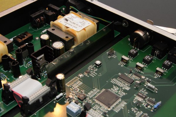

And since we are talking about XP-25 modifications, another very significant one I did is to remove the 100pF load capacitors labeled C21 and C22 on the main unit's board (after consulting with Wayne Colburn at Pass), in order to raise the load resistance to 1K. For the explanation behind this, see this thread http://www.whatsbestforum.com/showthread.php?15077-Cartridge-Loading-A-Misnomer ; but briefly:
Increased capacitance between cartridge and phono amplification circuitry will lower the frequency of the ultrasonic spike, which requires the application of lower resistive values to dampen the spike. Reduced capacitance between cartridge and phono amplification circuitry will increase the frequency of the ultrasonic spike, which can be tamed with higher-value resistive values.
Essentially, higher resistive loading results in better transients and higher resolution; as you will read, effectively, resistive loading has nothing to do with the cartridge and everything to do with the phono stage.

Final mods
During this year-long investigation, I realized the following:
a) the XP-25 is not shielded well at all (unlike, say, the exceptionally-constructed Moon 810LP) - not surprising, Pass are very well made, just not to fanatical standards (perhaps the Xs line is better?!?). It also appears to be more susceptible to hum pick-up from underneath than above.
b) the Alpha DAC's transformers are the main source of very significant amount of environmental hum, that the XP-25 picks up, especially when the DAC is under it, even if set 2ft apart; the DAC sits now well above the XP-25. In sharp contrast, the Etude tuner sitting directly on top of the XP-25 contributes no hum at all (not surprising perhaps, it is extremely well shielded as to not affect its own FM section)
These final modifications have rendered the XP-25 as quiet as perhaps possible (and certainly A LOT quieter than out of the box), to the point it's not affected by whether the DAC is powered on or not anymore. In addition, at max preamp gain, switching between the two inputs on the XP-25 (used and unused) makes for a very clearly audible difference, with the used one having significantly lower noise than the other. At normal and even loud listening levels, up about ~75% preamp gain, there is virtual digital silence with the XP-25's used input.
XP-25 shield top and bottom - copper over mu-metal (mu-metal is usually used for shielding below 100Hz, copper over that and really for RFI/EMI shielding):
JMW 10.5i - additional 0.5g copper mass still keeps overall resonance in the green zone (at this point, the arm is a combination of steel, aluminum and now copper):
mu-metal separating the Alpha DAC's transformer and main board - you feel the magnetic field as you are about to place that vertical mu-metal strip between them, therefore you know it's leaking over to the main board:
the single ground wire plug where all power-connector shields shown upthread finally meet:

Holland Shielding makes great products; the mumetal and copper shields that they make should be really effective, based on my own experience with the shields I have made; for example:
Theirs:
Mine (shielding of the RF section in my tuner):
