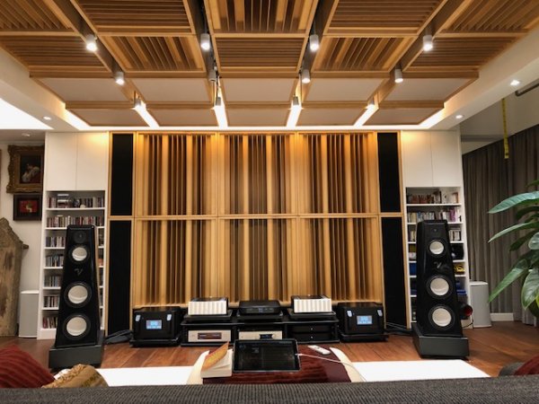

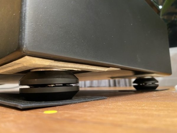

I do not subscribe to the diode theory of “draining” vibrations into the floor; I believe that any cabinet vibrations, if coupled to the floor in any manner whatsoever, simply excite the floor and result in undesirable drum-like resonances and subsequently time-delayed bass smear. Apartment dwellers, just ask your neighbor downstairs.
Not only do I decouple the speakers freely from the floor by “floating” them on Aurios Pro bearings (4 pieces per side), but place diaphragmatic bass absorber platforms (6”H x 16”W x 29”H) filled with activated carbon under each speaker to passively absorb the the low frequencies (both structural and some airborne) before they even reach the bearings. The results are just fantastic!

I do not subscribe to the diode theory of “draining” vibrations into the floor; I believe that any cabinet vibrations, if coupled in any manner, simply excite the floor and result in undesirable drum-like resonances and subsequently time-delayed bass smear.
Absolutely!
Even concrete floors sound bad when driven by speakers... I've never experienced a situation where coupling is better.
