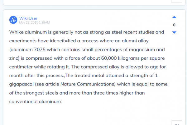

I would not use steel for the frame no dampning , there are Alu alloys that are as strong as steel and dampen much more , i would use something like ALU 7075 or possibly 6000 series or I would use phenolic resin based frames ( HPL).
With the right finite element couplers to the floor , no soft coupling to the floor ( loss of clarity)
