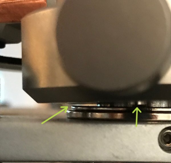

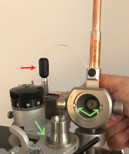

I started a thread a while ago about how I magnetically stabilized my VPI unipivot arm (one ring magnet and two opposing smaller cylindrical ones), to avoid its inherent wobble - it's linked upthread and there is a video plus magnet specifications. That tweak also afforded me wider macro-dynamics, and of course images stabilized and timbre improved tremendously. That's also to say that unstable unipivots just SUCK.
During the last six months, I have improved on the magnetic stabilization by using two stacked ring magnets of different thicknesses and outer diameters, against the original opposing ones for stability, as shown below. There are online calculators to graph the magnetic field of various magnet configuration, and I chose this particular configuration for good reasons. One is stronger opposing forces, but the more subtle one is apparently equally important: evidently, the bottom of this VPI arm is some sort of steel and slightly magnetic; by using this combination of stacked ring magnets, they can every-so-slightly attract the arm when it's lowered (see third picture), though that inevitably affects VTF (but I compensate with the counter-weight). However, the real end result is that the arm is also stabilized on the vertical plane, offsetting subtle vertical movements by the cartridge, as it tracks the depths of the LP. Because of where the ring magnets are positioned in relation to the overall arm length, varying LP thicknesses have no measurable or audible effect, and the vertical stabilization is still as effective.

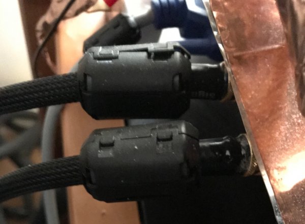

In conjunction with the use of ferrite beads (remaining pictures), here's the real sonic result: I don't recognize my analog. It is so alive, extremely resolving, dynamic, with presence, deep and tight bass, three-dimensional, with excellent micro-dynamics, that I literally do not recognize it. New sounds are popping left and right. I can easily hear pre-echo with many LPs, including D2D like For Duke and many Sheffield (apparently, there is a delay in the cutting process even for D2D), Telarcs, RRs, etc. I had some local folks over about 6 months ago, and the sound was plenty dynamic and resolving. This is now at a much higher level; the performance increase is just staggering, and I am re-discovering my collection.
Bottom line: a) as we all know, a great cartridge needs a great arm; b) the Pass XP-25 is susceptible to noise picked up by the cables, but in the end, as modified, a great phono stage; c) the tonearm cable sticking out no longer affects VTF as the arm moves across the LP
With respect to ferrite beads, I now have them everywhere, and their effect was only positive. Most folks don't care for them, so the only thing I will say to them is this: you have no idea; and they've had the most effect on my analog.
The stacked ring magnets, plus the opposing ones (and a ferrite bead on the tonearm cable):
Arm lowered, side view:
Ferrite beads on the phono cable and out the Pass XP-25:

I'll try ferrite beads again, last time it was awful, but I had different cables.
The important thing about ferrite beads is their operating range, thus, they must not be chosen randomly. For details, see http://www.analog.com/en/analog-dialogue/articles/ferrite-beads-demystified.html
I chose mine with an operating range over 1MHz, in order to absorb noise that would: a) otherwise affect the peak resonance of the phono stage/cable/cartridge combination, which is typically roughly in 1-2 MHz range (there is a thread on WBF on this, named something like 'Cartridge loading is a misnomer' - http://www.whatsbestforum.com/showthread.php?15077-Cartridge-Loading-A-Misnomer); and b) affect the Spectral devices, which operate well above 1 MHz.

I put a ferrite bead on my phono cable. Near the phono preamp it did nothing. Towards the TT it may actually have a nice effect. I will listen for awhile with it (days), and then remove it to see for sure.

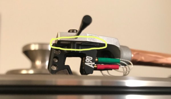

A daring tweak
Vinyl is so incredibly complex and frustrating, but also very rewarding. The picture below shows a very thin layer of sorbothane in the shape of a T placed between the cartridge and the headshell. The results are immediately noticeable as further clarity and articulation in the highs, with noticeably less edginess. A simple tap on the headshell with a metal object results in a duller thump, with less high frequency content and ringing. The screws already use plastic washers. The real problem with this presumably easy tweak was re-aligning the cartridge - what a pain. I have not noticed any drop in dynamics or bass performance, and VTF was only affected by 0.1g, easily compensated.
Interesting. Congratulations on your continued quest via tweaking to improve your sound. Why do you think that decoupling the headshell from the arm tube causes such an improvement in sound quality? Are vibrations from the cartridge now not traveling through the arm tube to the uni-pivot bearing or are vibrations in the arm tube now not hitting the cartridge? Given the compliant nature of sorbothane, you could adjust azimuth by simply torquing one mounting screw more than the other. You could also design it in such a way to adjust VTA at the cartridge which is what the Acoustic Systems headshell from Germany does.
I would think that this tweak would not be as effective on my SME arm because the headshell and arm are designed to take all vibrations from the cartridge away from the stylus and to the gimbal bearing and massive armboard. Your report offers an alternative take to what I have always read as a desire to have a very rigid cartridge/headshell interface. Doesn't the A90 have three small mounds on its top face for better direct coupling to the headshell?
I like the copper foil over the arm tube in the photo. Nice look.
The A90 appears to want to operate isolated, so I am building on top of its isolation design, which is two-fold: a) the contact area with the headshell is deliberately small (just two very narrow perpendicular lines, forming a T); and b) the built-in damping system, described best in its manual:
WRD system
Adding to the list of important components is Ortofon’s patented Wide Range Damping (WRD) system. In this system, a small, heavy platinum disc is sandwiched between two rubber absorbers, both with different properties. This ensures not only an exceptional tracking performance, but also create a perfect damping through the entire frequency spectrum. Because of this, distortion and resonance are virtually eliminated entirely
Although the cartridge/headshell contact area is now larger, the sorbothane damping appears to absorb ringing by the metallic arm. The decrease in high frequency distortion is quite noticeable if you are coming from years of playing records one way, and the increase in articulation even with very quiet passages is also quite apparent - I was playing Carmina Burana on Telarc, and the subtle triangles during soft chorus singing were quite distinct and complete, which was not the case before).
Yes, it's unclear how well this tweak would work in other systems. What is clear yet again is how important the arm is to an analog system.
