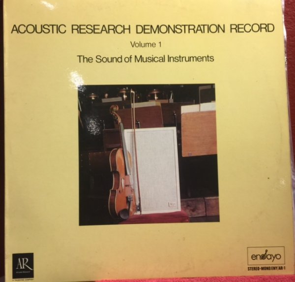

The best ever (IMHO) cello recording for evaluating systems is one I have used for decades - a several minutes excerpt from the Kodaly Op. 8 sonata. While most selections on this demo record were taken from other sources, this demo piece was engineered especially for the record by Ensayo with a minimum of room reverb, so the full range and all the nuances of the instrument spring forth in true-to-life fashion.
