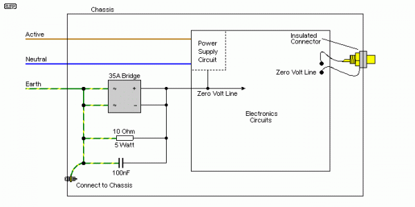

And finally, there are ground loop breakers, which placed between a signal ground and the safety ground, can deal with a multitude of sins... Then again, this requires incorporation into the circuity of a component.
http://sound.westhost.com/earthing.htm

In a nutshell, this is an easy problem to sort out. First: the chassis should be tied to the ground pin of the AC cord no if ands or buts.
Second: the circuit ground is not the chassis. A connection is made between the two with an impedance high enough to render ground loops impossible. Rectifiers are handy to cause fuses to blow if there is a serious problem.
I'd not realized folks were using diodes in their standoffs 60 years ago. Neat.
Is that similar to the ground loop breaker I referenced previously?

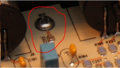

I believe the following is an example of this from the Berkeley Alpha Reference:
