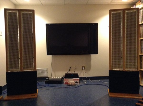

I have recently added Acoustat Spectra22 to my 11X14 mancave. I was worried I might not have enough room but it has actually worked really well.
My front wall has two 2'X4'X4" absorption panels on either side of a 60 inch TV basically behind the speakers. I installed these for the previous speakers, Totem Hawks. I have experimented with the panels on and off the wall and in my small room I prefer the sound with the panels up (front wall absorption). It is just too splashy and unfocused without the absorption. The Spectras are about 3 1/2 feet from the panels. If I had twice the distance to the back wall things might be different I'm sure.

So you've created a planar MTM configuration. Cool.

Most panels radiate as line sources as frequencies go up and thus radiate little off to the sides (and top/bottom). The back wave is an issue, however, and the likely reason placing equipment in the middle made such a difference. I noticed the same thing and eventually figured out why. That is another reason I prefer to damped the wall behind the speakers; then, it doesn't matter that I have an equipment rack (or big TV) between the panels. It also allows you to place them closer to the wall behind.
Caveat: Quad uses a special pattern in their panel to make the radiation pattern more conventional, a mixed blessing IMO, and some designs such as Martin Logan use curved panels so do radiate more broadly (ditto).

Greeting Don. As you can see, I do have some dampening on the front wall, but I do still think that if I could lower the equipment a bit, it would allow the speakers to breath a bit more. But, as you can see from the conversation we're having, I'm kind of stuck between a rock and a hard space. I knew I should have bought a bigger house. LOL.

No worries, it was a general comment in response to "Big Dog RJ"'s post, not directed at you (or anyone) in particular.
It's hard to tell perspective from your pictures but placing treatment so that the sound waves from the back of the speaker panels radiate into the absorbers (or diffusers) will mitigate the impact of the equipment in the center. It really comes down to how you like the sound with more reflected sound from the room. That provides more "space" but also more impact on frequency response, imaging, and so forth. I have had many setups over the years and in a large room prefer to reduce the amount of sound treatment but not eliminate it. In a smaller room I much prefer the sound with more treatment. Imaging is much more precise, sweet spot is wider, no (or less, anyway) comb filter effects to corrupt the frequency response, etc.
